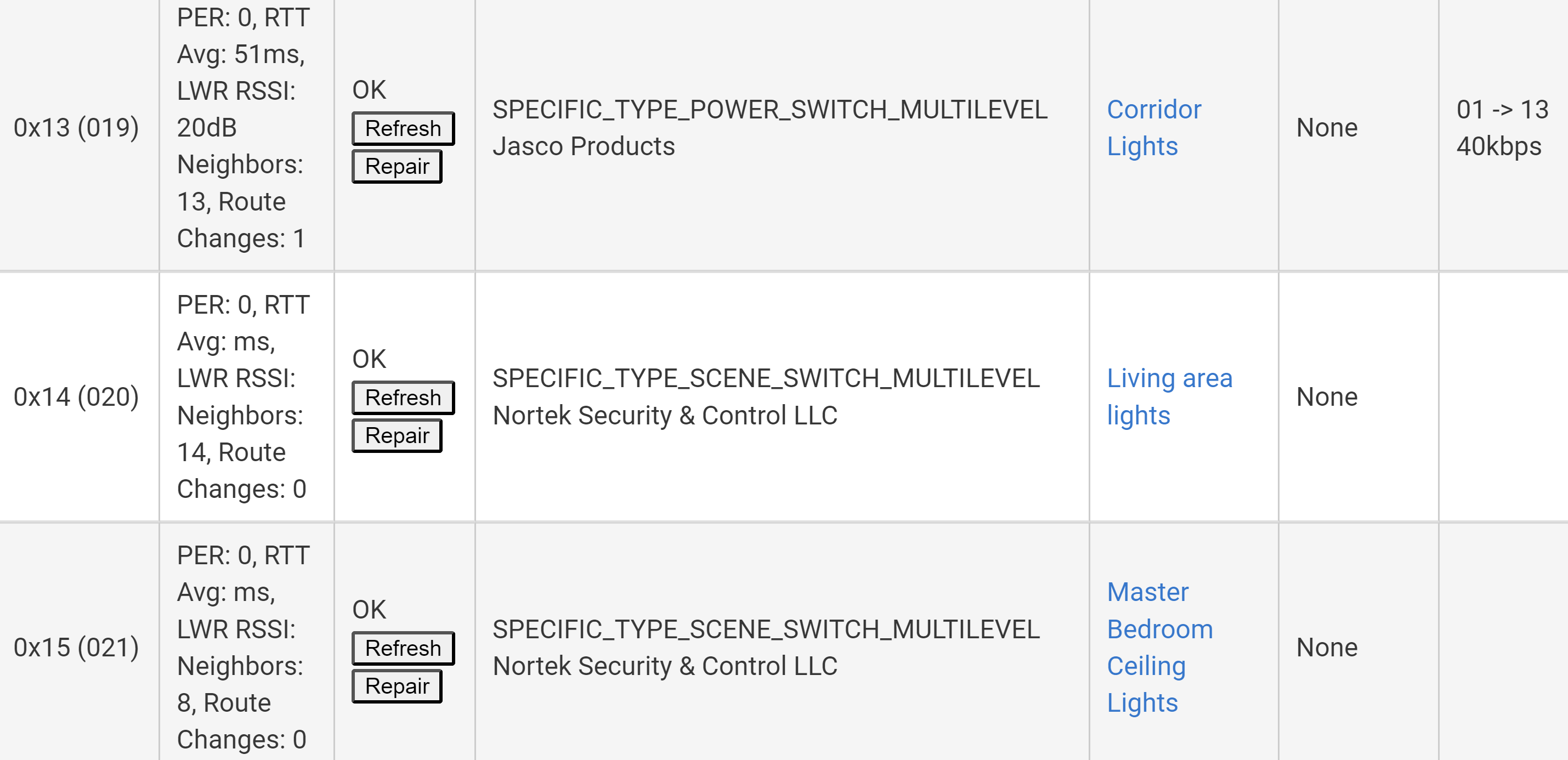

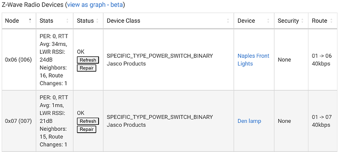

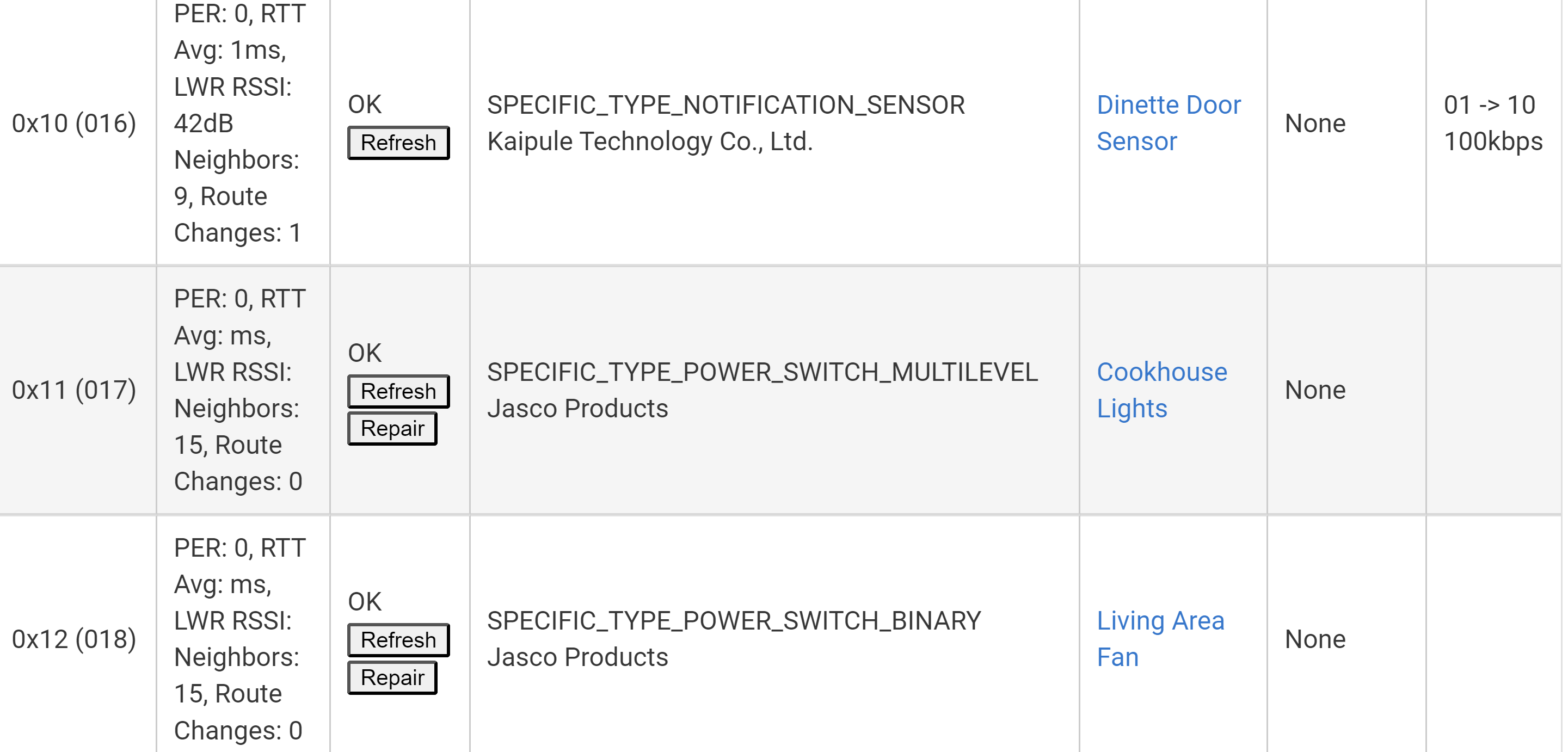

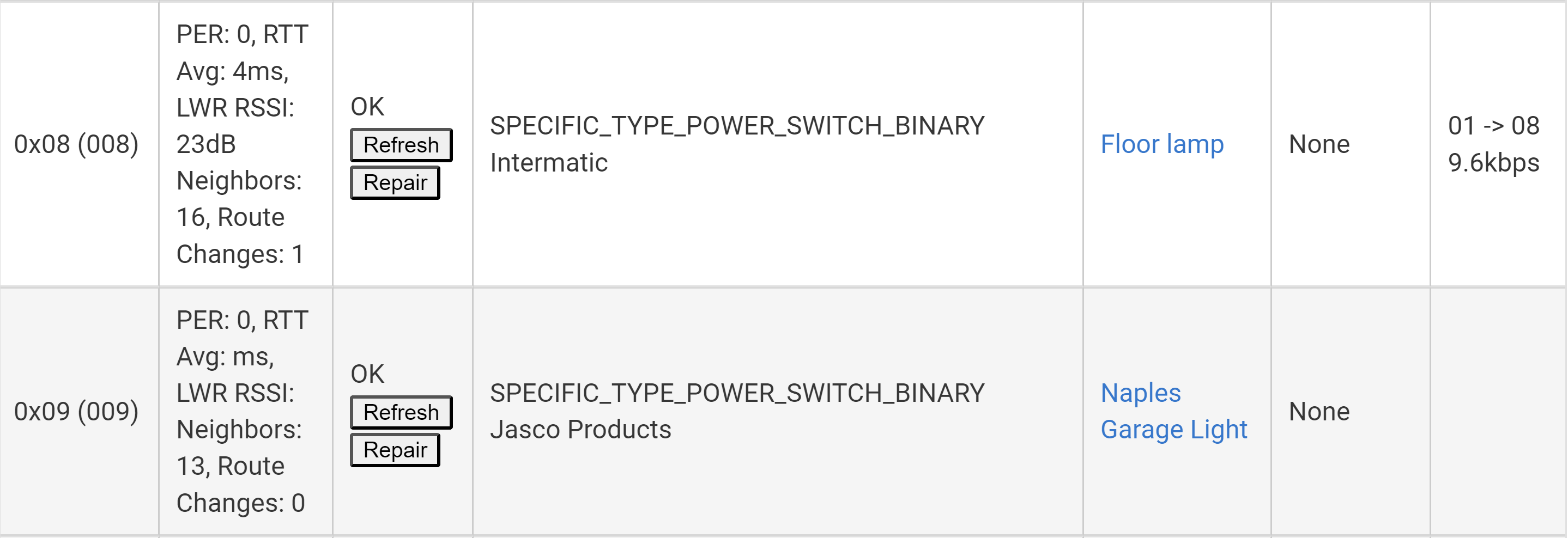

Can you post your z-wave details page in its entirety? (Use windows snip)

Here is the Zwave info:
