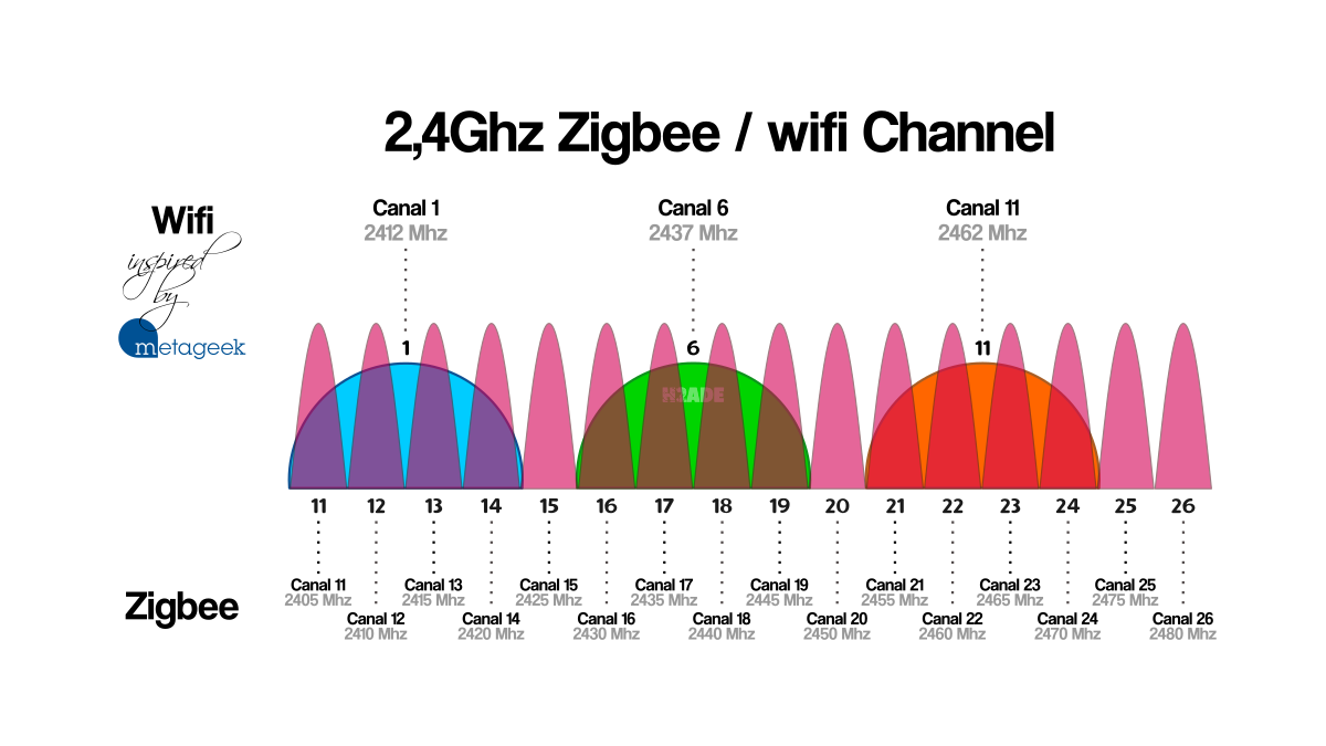

How far is the closest mains based unit to the lock(s)? Are you still using the same driver that you used on the C7? Is the c7 still powered up? Did you change the zigbee channel on the c8 (recommended to have the hub 20 or above and your wifi 11 or below so they don't overlap). If you bring up the View As Graph option on your zigbee details page, does it show going straight to the hub or via repeater?
I tried 20 but didn't know about a conflict with 11. I have two 2.5GHz and one Sonos. They use 1,6 and 11. The graph no longer shows the locks since they dissappeared but it was direct to them -- not through a neighbor. The nearest main is maybe 8 feet from the hub. I have tuya or other zigbee in-wall switches. The in-wall switches by the way have no issue -- it is only the Yale Assure Zigbee locks.

nuggets of gold. thanks! 20 and 11... copy!!!
