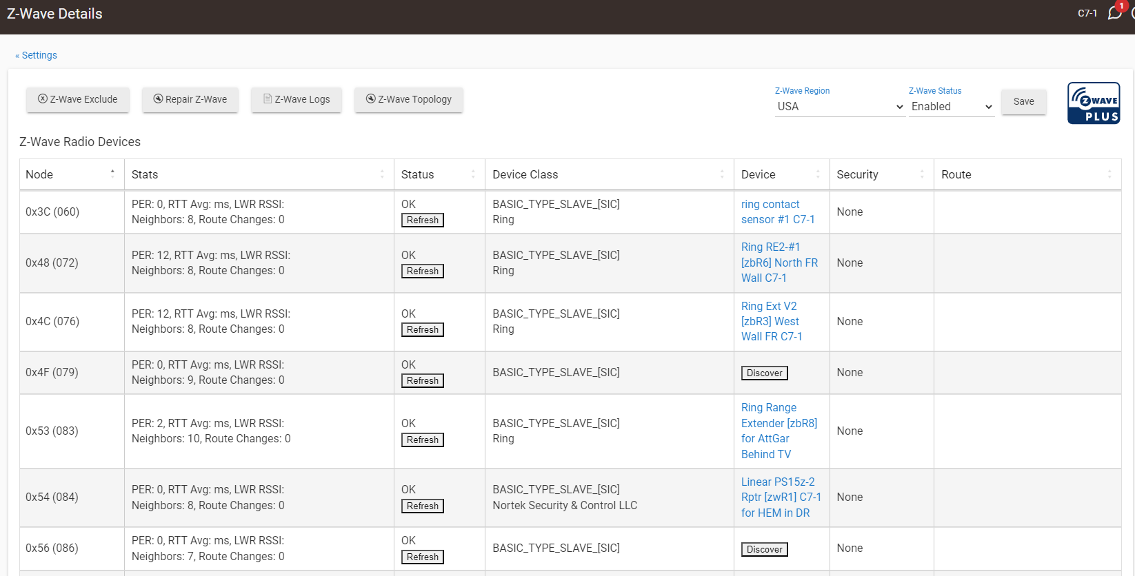

Most devices on the zwave detials page have no routes:

A soft reset or restore is unlikely to help, as that affects only the regular hub database, not the Z-Wave radio contents. But if it does keep happening, it may be good to see if you can figure anything else out. Nodes 0x4F and 0x56, for example, look suspicious in your screenshot and would be good to remove if you can (but see if they look normal again after the full restart just in case it's so messed up that this display isn't right, I suppose!).
I would take @bertabcd1234 's advice. The routes will show as the device gets used. But you do have 2 ghosts though that should be removed. They'll inhibit your mesh
