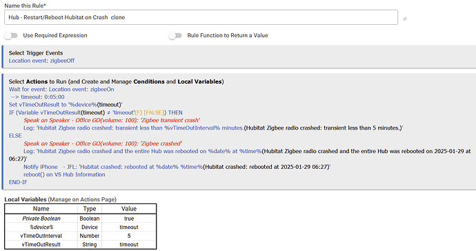

See this post for an example of a Rule to deal with the problem symptoms (the rule doesn't fix the problem). The entire thread may be of help.
If you implement the rule I posted, you probably need the latest version (below) AND to install the Hub Information Driver v3 AND create a virtual switch using that driver (that will enable the "VS Hub Information" value in the reboot() line of the rule).

If I read it right, this rule restarts the entire hub if zigbee radio doesn't come on within 5 minutes, while it announces the event (not such a great idea since this has occurred in the middle of the night) and logs the same events I'm already seeing.

The text in red indicates that rule command is disabled; I used the announcements only for debugging purposes.
Only actual hub reboots are notified to my phone. Short Zigbee radio crashes are just logged.
The MAIN purpose of the rule is not the logging or notifications, it's rebooting a hub that has finally stopped even trying to restart the Zigbee radio.
