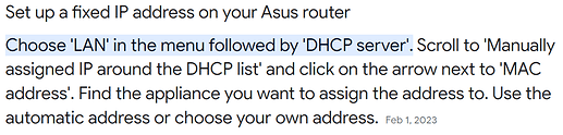

A quick Google on "Asus DHCP reservation" came up w/this below - there are likely differences in where the feature is found on different Asus router models, but look for the "LAN" option initially...

Yes that's what happened, I enabled a setting. And when I went to log back in, it's not accepting my login info. Kind of frustrating to be honest, at least for now I got the hub working :smile:
That's really odd if you mean you enabled a DHCP reservation for your hub on the router and then couldn't log back into your router, makes no sense...DCHP reservations should have zero impact on your router log in. Glad the hub is up, but obviously you'll have to figure out the router issue...think of it as more fun where you learn new stuff. :slight_smile:
