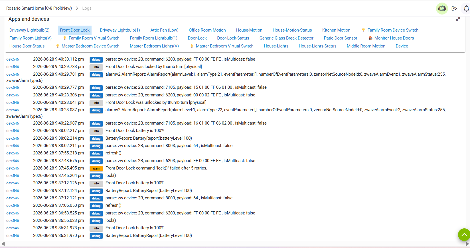

Debug logs show repeated lock() attempts followed by:
Front Door Lock command "lock()" failed after 5 retries
Physical lock/unlock generates Alarm Reports and status updates correctly.

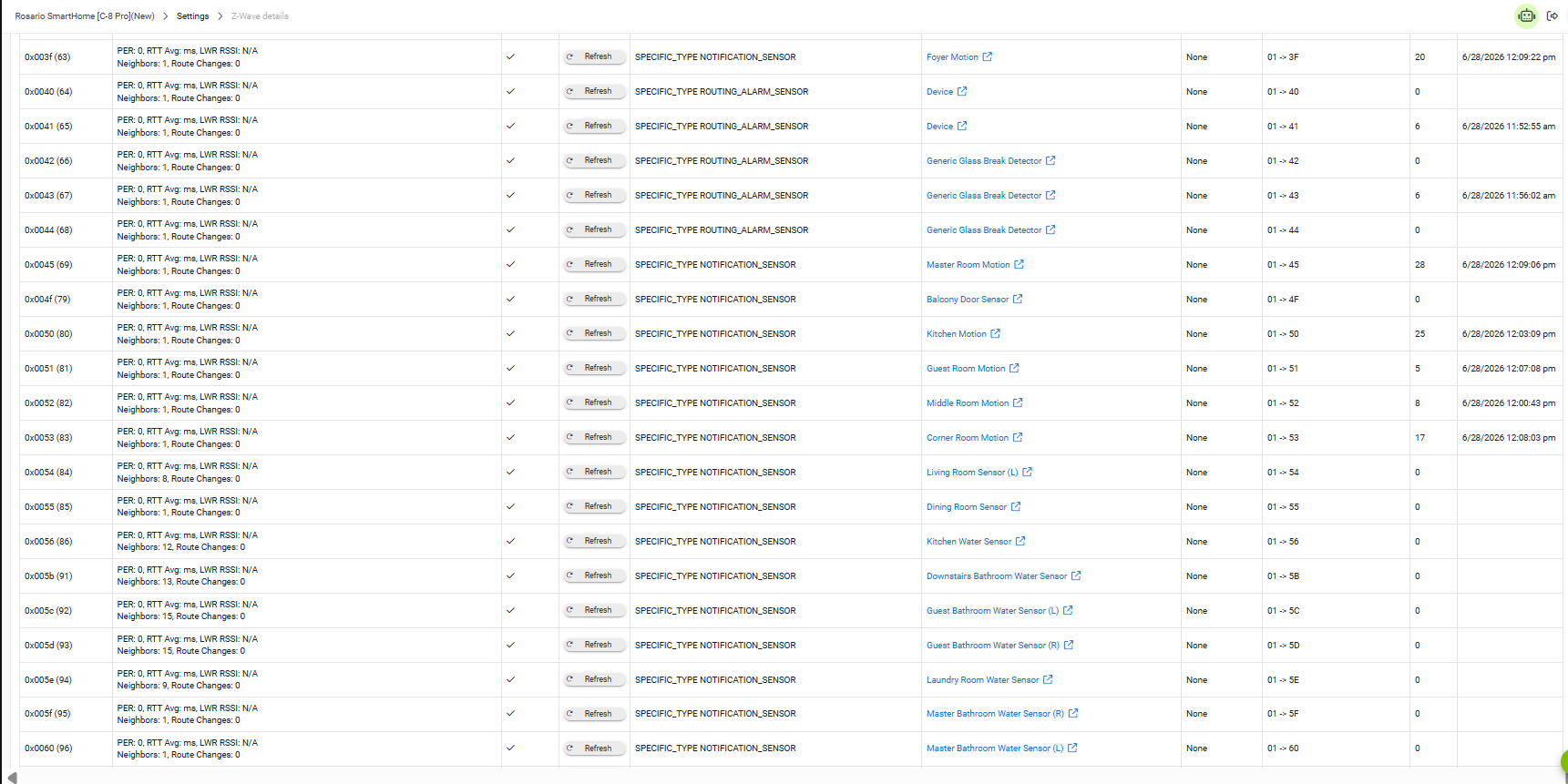

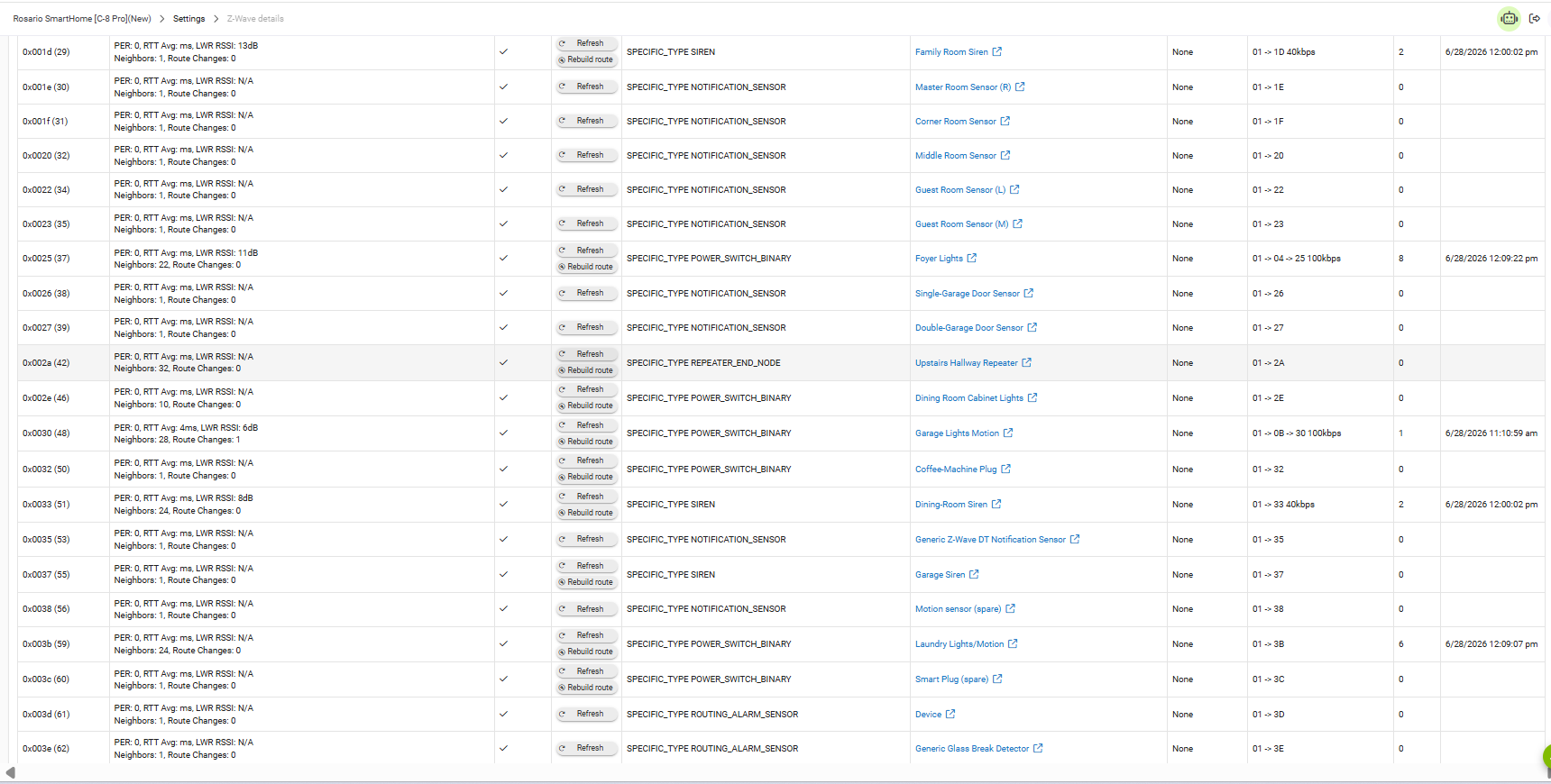

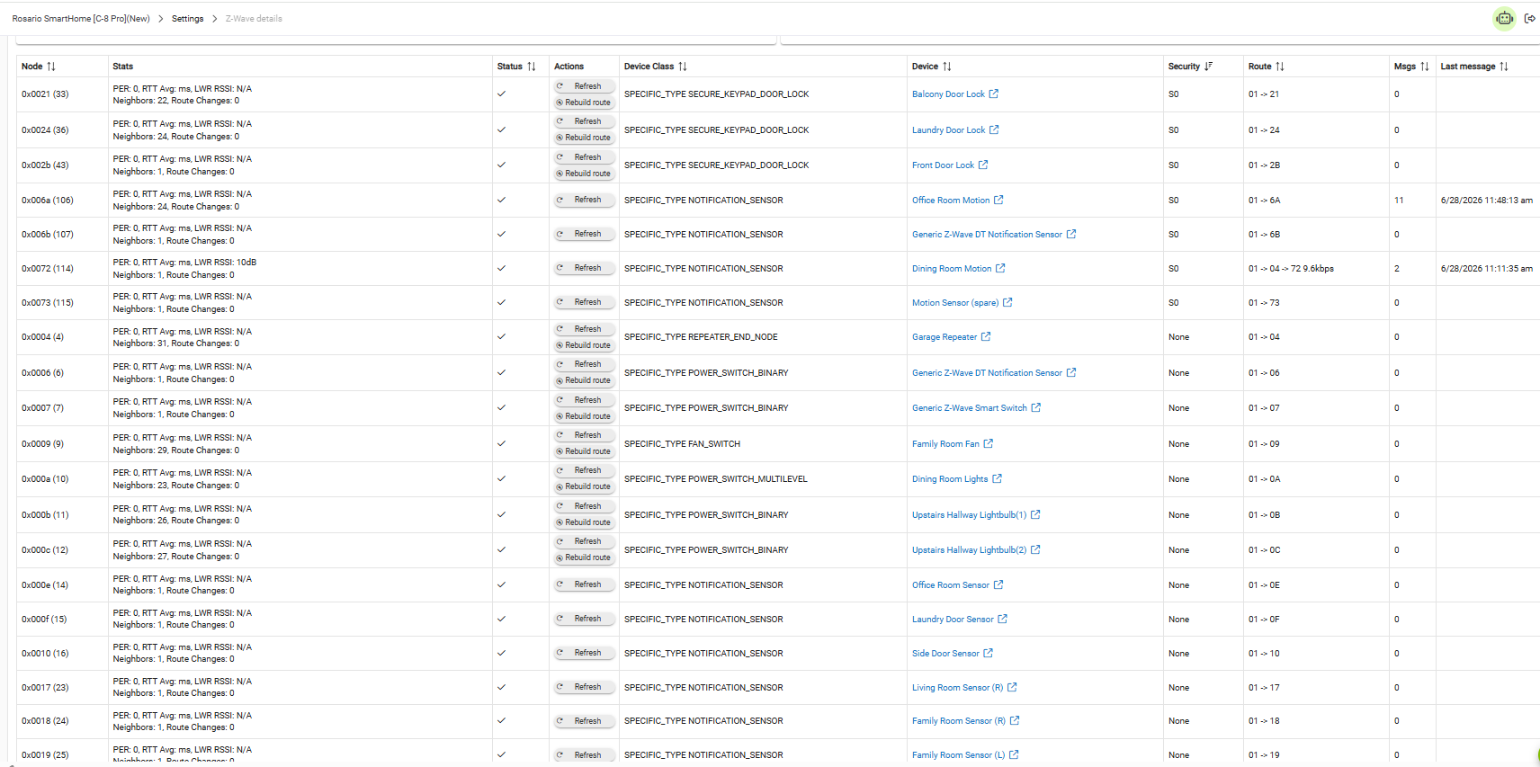

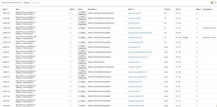

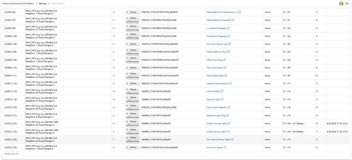

@bennycakes For giggles can you post your z-wave table in it’s entirety? (use windows snip)
If confirmed working well, I would factory reset the new hub. Then I could do a database rebuild on the old hub then to a full power cycle on the old hub by shutting down then unplugging power for 1 minute then powering backup. Then re run the migration.
Thanks for the suggestion. Yes, it is a real pain to exclude, reset and include Schlage locks and with three of them,…may take forever. But I will consider doing a general exclusion on one of them.
I have attached my z-wave table which has 81 devices, including virtual ones. The screenshots at 70%. Let me know if you prefer 100%. Thanks for your support and help.
By the way, I am new in posting to the Hubitat community. So please let me know if there is a better to post and upload these screenshots. Thanks
Overall the table looks good. I’d redo the migration with the power cycle I described above then see how things run (also after the migration backup is made, shut down the old hub)
