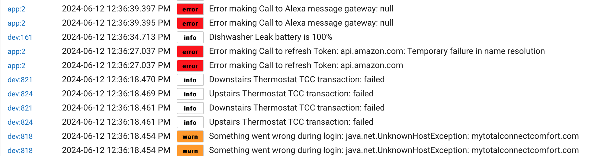

Once the hub came back up I looked in the logs and I noticed the following. DNS entries appear to have started failing earlier this morning. I wonder if those errors piled up in some way and caused the unresponsiveness. I have attached a screen shot of those errors. I'm not sure why this is happening but wanted to make someone aware of it. I'm happy to help in whatever way I can.
To my eyes, it's one failure (DNS) displayed a bunch of different ways :slight_smile:
All of those logs are related to Internet services, Amazon Alexa and Honeywell TCC

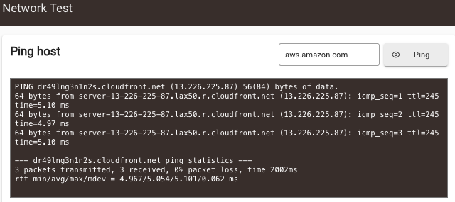

Goto Settings: Network Settings: Network Test (in the very top line of text)
Use Ping to a NAMED site and look at the results:
Screenshot 2024-06-12 at 9.26.15 PM
You should see the name to IP address and that would validate DNS. If not, your hub is blocked from the internet by something on/in your home network.
Once the hub is rebooted things work normally. DNS is resolved as expected. I ran the test mentioned and it works fine. To me this seems as either the Ethernet Interface is going down somehow on the hardware, the network stack is borked, or some combination of the two. I forgot to try and ping the interface so I don’t know if the interface was responding or not. I’ll have to wait for this to happen again to do more extensive tests. What I find interesting is that the DNS failures started hours before when I noticed the problem. It’s what makes me lean towards the networking stack/interface getting borked but without console access everything is pure speculation. I feel confident it’s not my network. I’m running Ubiquiti gear and I’ve had no other problems on the network. I can’t 100% rule it out but given the symptoms I would be surprised.
