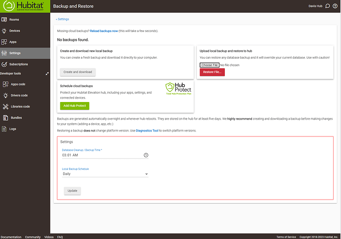

I've been beating my head against a wall trying to figure out why I cannot do a cloud migration. I have tried (and seemingly successfully) backed up several cloud images from my C-5 hub. When I try to do the restore to my C-8 hub. All I see is the screen below. I can click the 'Reload backups now', but this does nothing except spin the wheel like it's doing something and then nothing.
You need to update the hub firmware. Go to Settings and check for update
