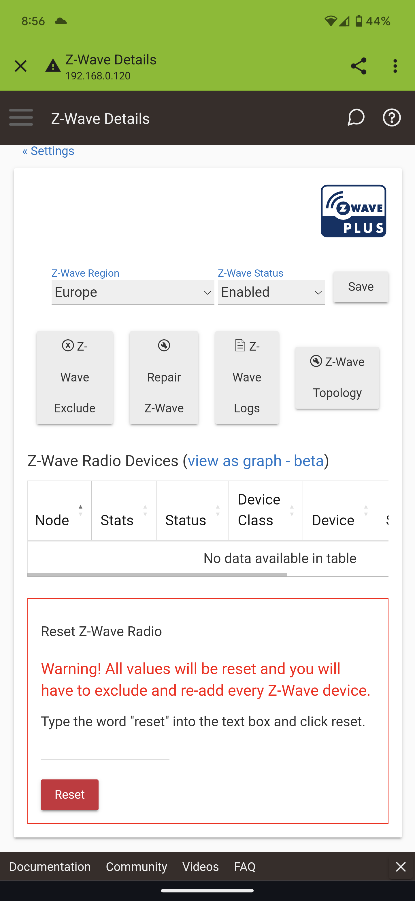

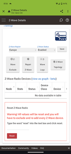

Post your z-wave details page so we can make sure it's ok
Here you go, I only have ZigBee devices though. Everything seems ok.
Ahh, was gonna check for ghosts. NM... Carry on! :slight_smile:
