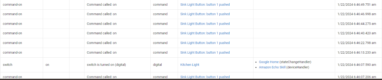

I am using a Zen 37 button controller to control three different lights and do some dimming. All was working fine until I replaced a zigbee Enbrighton switch with a Zen 73 and now the button that controls that switch which is set to toggle it only sends on commands. Same button and button rule that was being used with the previous switch and toggled correctly. I am using the Zooz Zen switches Advanced drivers. My Hub is a C8. Logs show Single pushes for the button and on commands for the switch. I think @jtp10181 will know why.

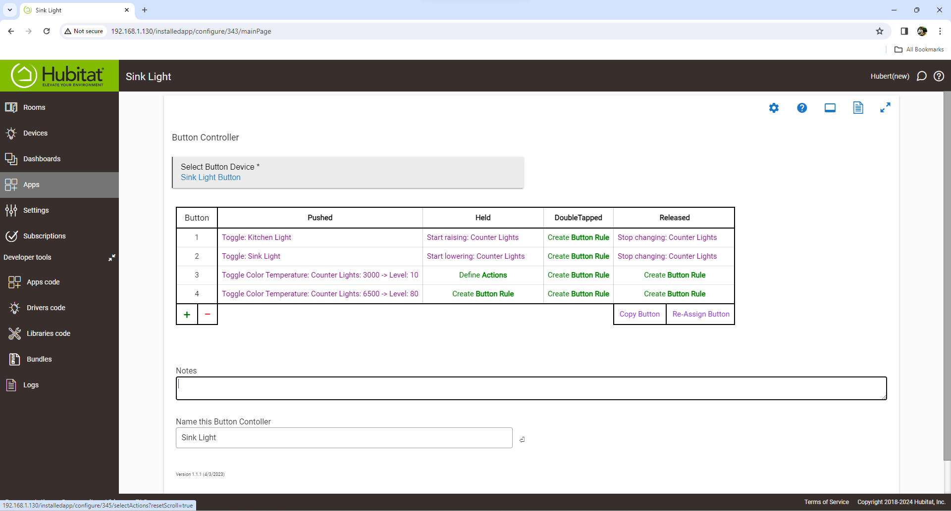

The old switch may have supported the "toggle" command. Try removing the toogle action from the rule and adding it again for the ZEN switch. Post a screenshot of the rule if still not working and I can test it out on my end.
@jtp10181 Dont know if I did what you asked but I took the kitchen light out and put in another light and it toggled fine. Put the kitchen light back in and it only toggles on.
No, not just change the light, actually remove the action so then the rule would be blank, and add it back again. I will test it out myself when I get a chance later today.

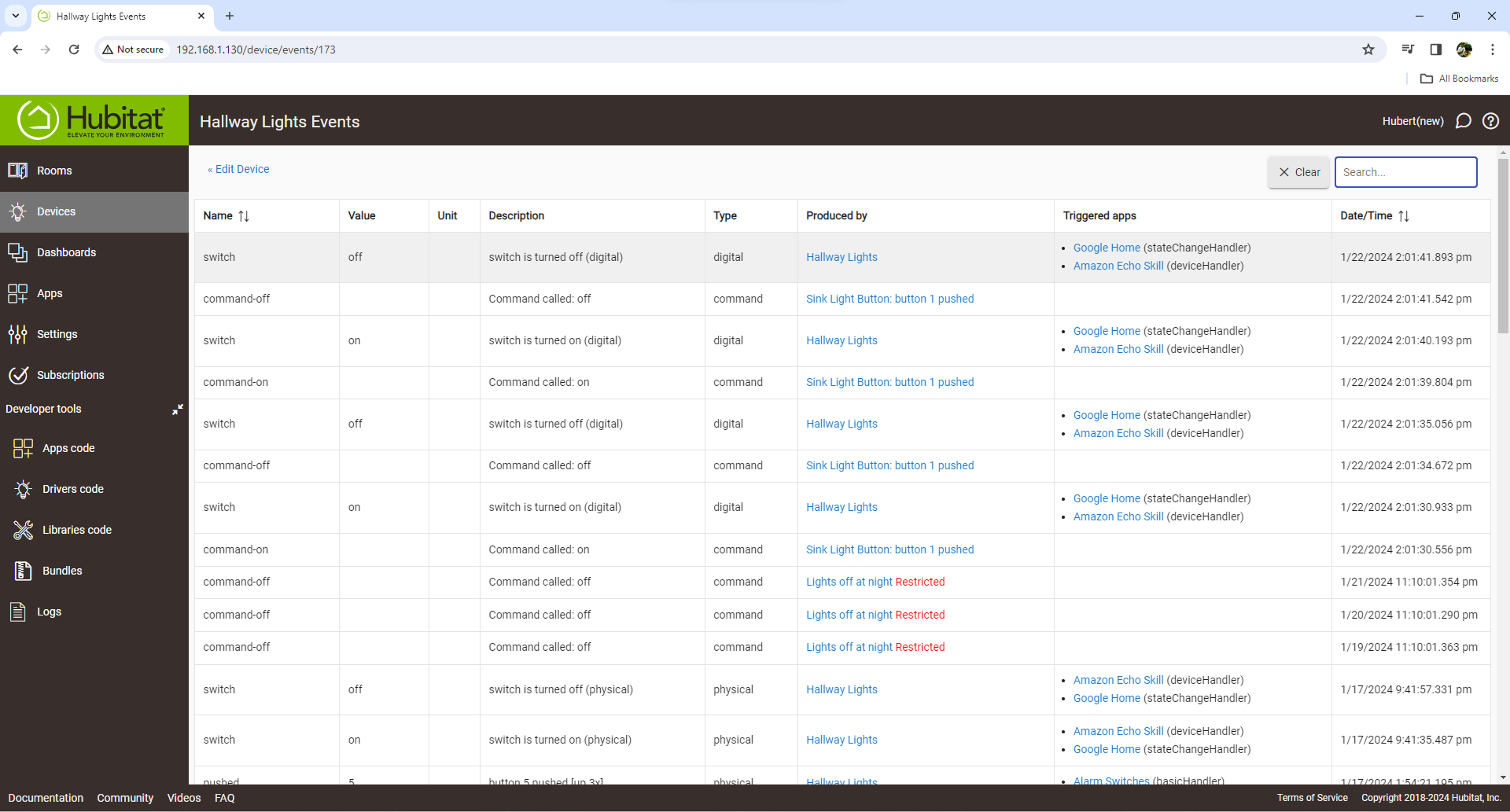

@jtp10181 Something I tried, replaced kitchen light with hallway light which is also a Zen73 and it toggled correctly. Put the kitchen light back and same thing. Took screen shot of events on both devices, dont know if it helps trouble shooting. I am really impressed by the things you and others do on here, wish I knew more

Looks like the driver is behaving as expected, but the app keeps sending the on command for some reason.

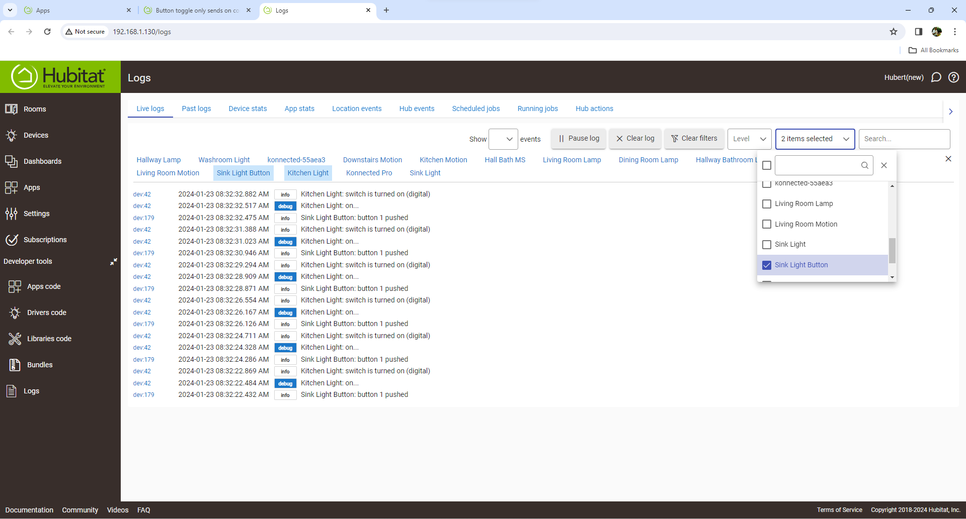

You should show a screenshot of Current States for the device. I don't think the logging is going to show anything useful. The most obvious possible reason would be the switch attribute not having the value 'on'.
Im not sure if I got all you asked for, could not find anything in the rule to turn on logging or see rule logs. Here is what I got. @bravenel I do see that the device (kitchen light) always shows the correct on or off state. I will try the driver swap next and let you know @jtp10181
