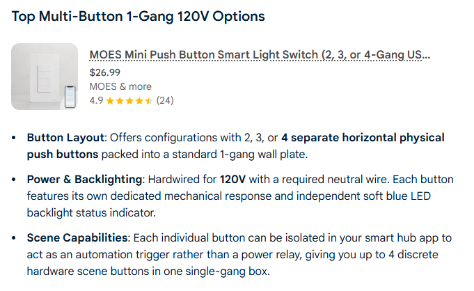

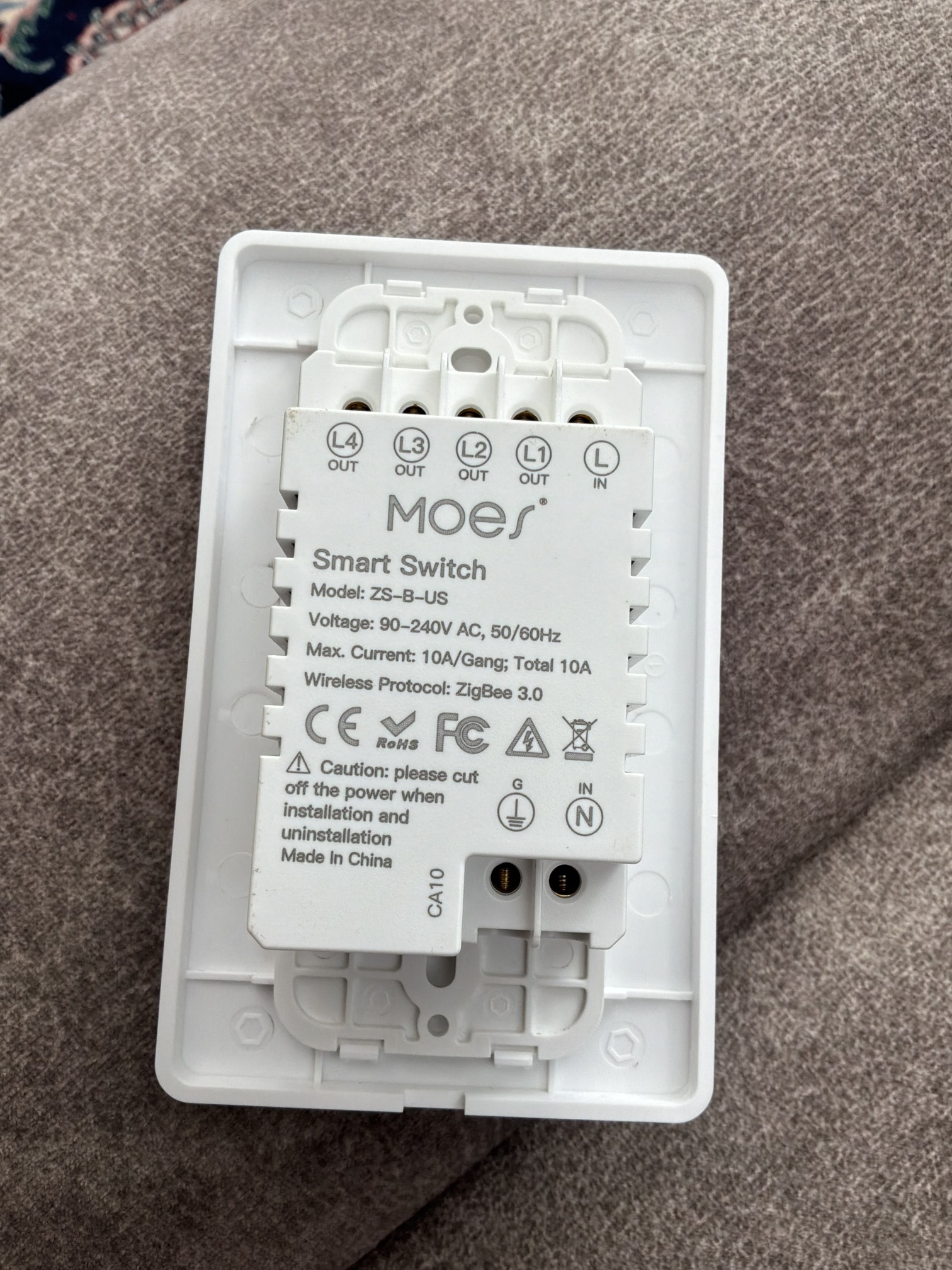

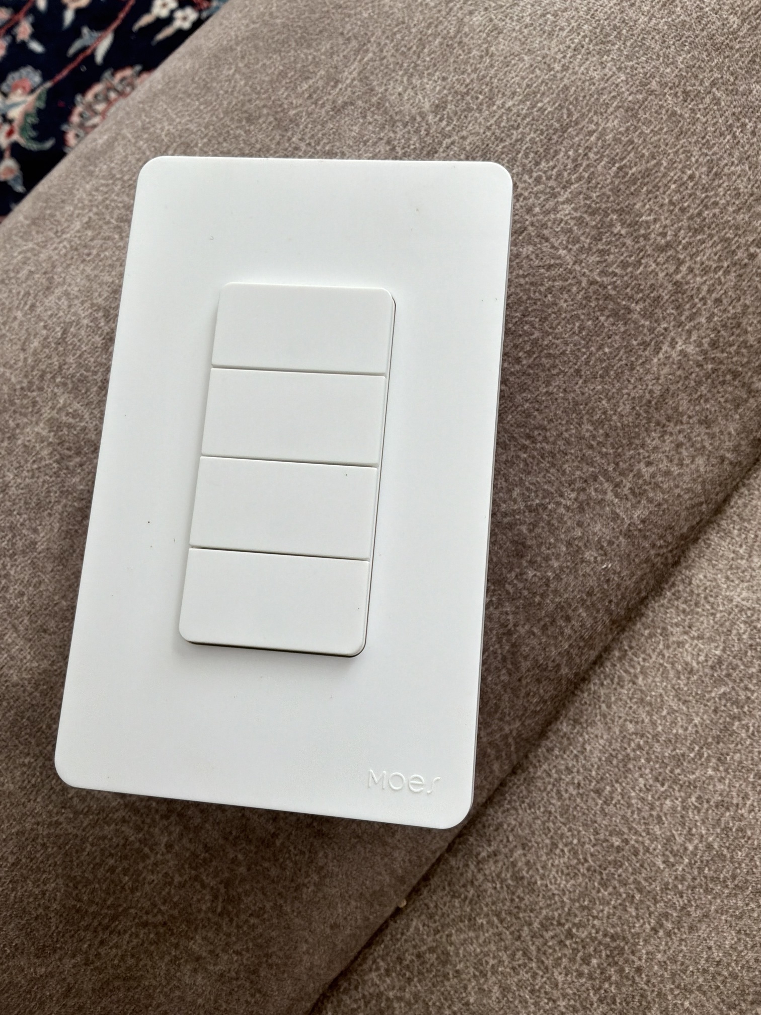

I just found that Moes makes a 4 button 1 gang Zigbee button switch that runs off line voltage and has blue backlit buttons. It actually will switch loads as well, but you could just use it as logical buttons without attaching anything.
Everything is so close but not quite. The MOES says you must buy their hub and can't use Smartthings and whatnot.... Why have a Zigbee product that isn't universal? I'm really surprised no one has done something like this with Z-Wave/Zigbee. I think an RGB backlit station with engravable buttons and a few different colors/finishes would sell like crazy if it were available to the general public. Hello, Zooz??
I have this and it works amazingly well with Hubitat. No additional hub required.
