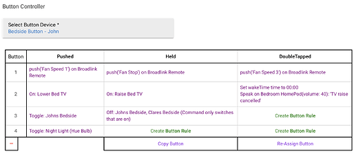

Apps > Install Built-in app > Basic Button Controller. It's similar to Rule Machine but more focussed on buttons. Example of one instance of mine:
Edit: Re read your post and can see that you need more than single tap, double tap, release. Maybe there's some community app someone can recommend.... Though you should be able to achieve what you've said in your example. Number 2 - cycling through the different colours on consecutive presses will need some additional logic possibly to store the current option and pick the next. All doable though.
