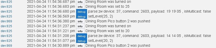

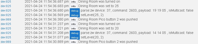

Might be a device/driver issue, as the fade time is not respected when executed via the app either. Same behavior with Rule as with Button Controller, no control of fade time.
This is a Zen77 dimmer with the built-in Zen77 driver. My particular usage is controlling the dimmer with a Lutron Caseta Pico.
Did you mean the device page? If not, try it there to rule out any app issues. If it doesn't work with the "set level" command directly from the device page, no app will work with it either.
If it doesn't work, there's probably a driver problem (I can't imagine any modern dimmer wouldn't implement this ability), but I don't have the ZEN77 so can't say for sure. If you see any errors in the logs when you try or it enabling debug logging shows you anything about what commands are actually being sent (not all drivers do this), that may help someone figure it out.
Yes, apologies, I meant the device page. Does not work with setlevel. I don't see anything odd in the logs.
