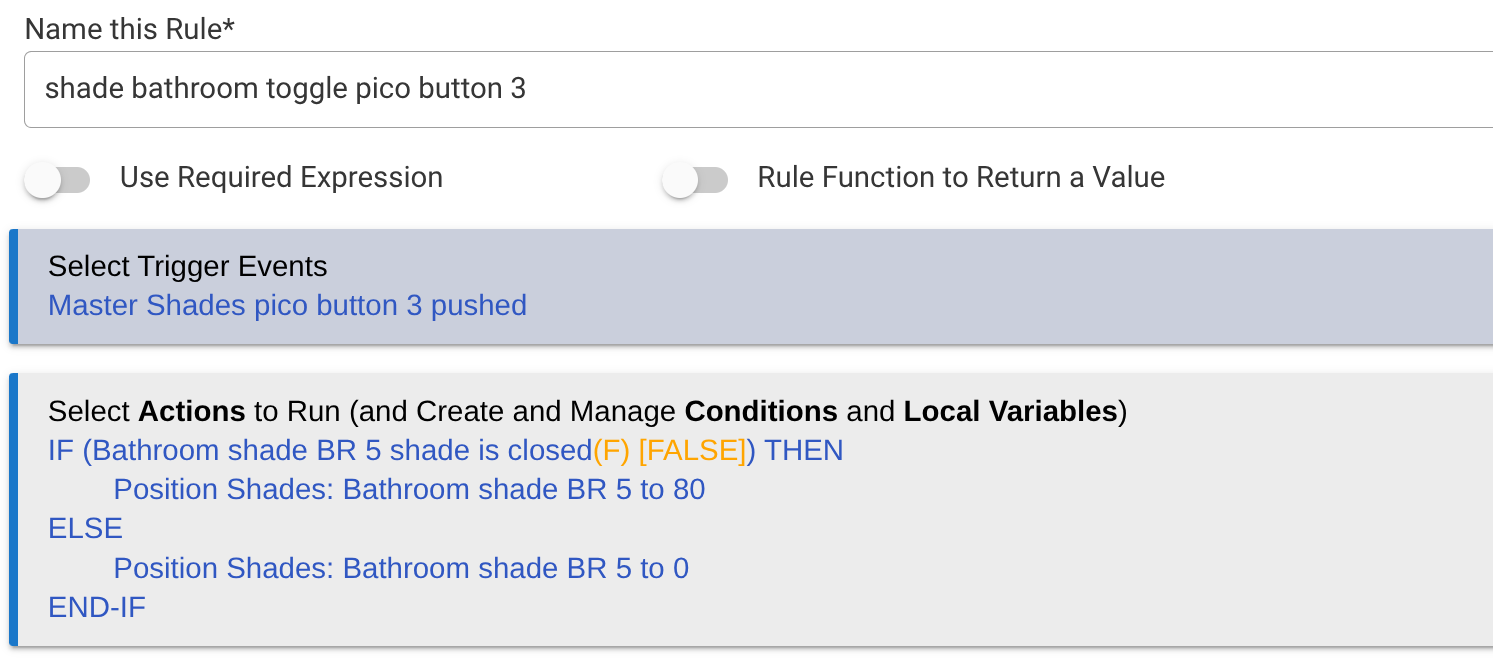

I do something similar with a pico button to toggle open/close a shade. You could use a button to toggle on/off a virtual switch to control a large group of lights. Or with a room Lighting Activator.

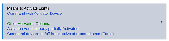

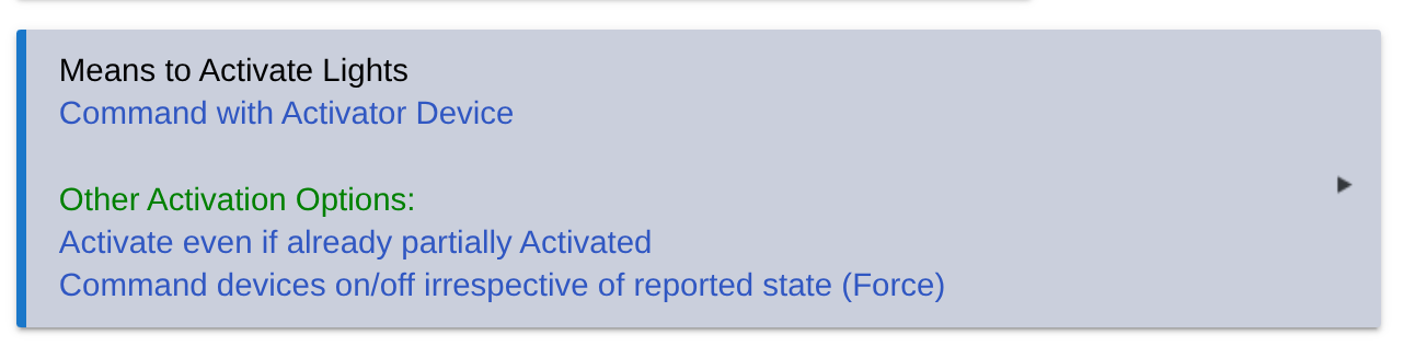

Room lighting, though a bit complicated, provides the option of setting a state regardless of the current state.
Oh nice! I had pretty much all my automations setup already when Room Lighting came out, so never used it yet… Good to know though!
