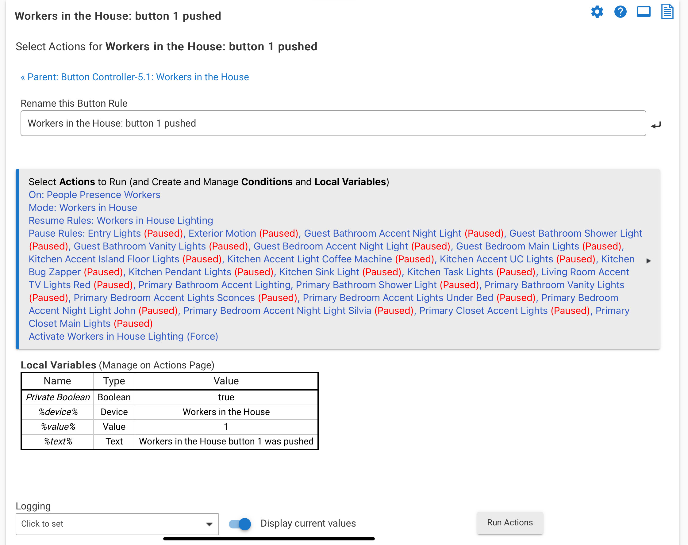

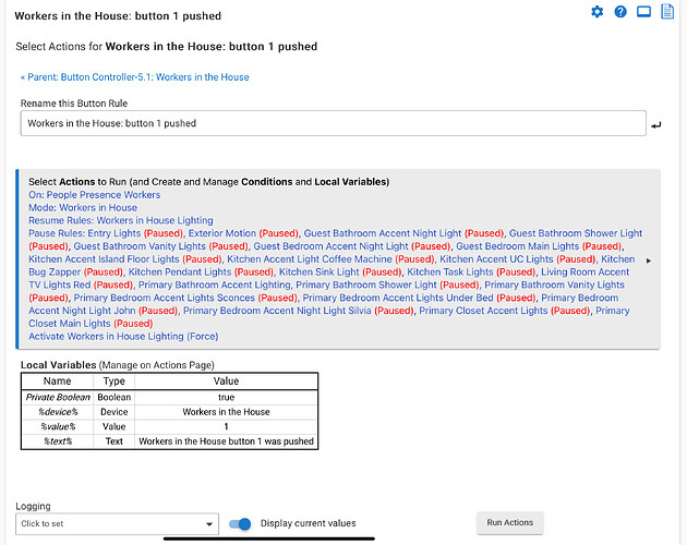

When I push the button, it turns on the presence switches, changes the mode, pauses all the Room Lighting apps and resumes the “Workers in House”.

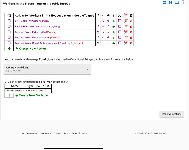

However, when I double-tap to reverse the process, it only resumes the first Room Lighting app in the list. It seems to ignore resuming the rest of the Room Lighting apps. I’ve tried both as a list (checking each app), and setting up multiple actions to resume one-by-one. I’ve added delays and it still doesn’t work. What am I missing? This seems so simple, yet it isn’t working.

Turn on Action logging for that rule, and then post a screenshot of the logs. I just created a rule that pauses two Room Lights instances, and then resumes them. Both actions work as expected. BTW, you can combine those three actions into a single action.
