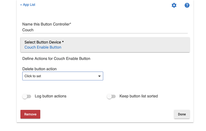

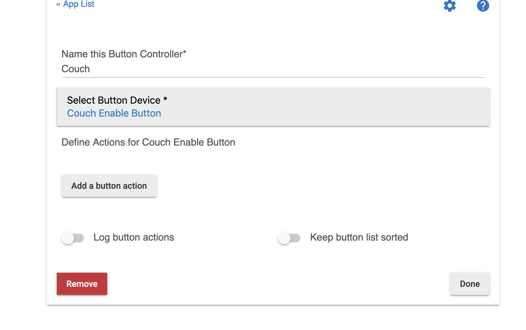

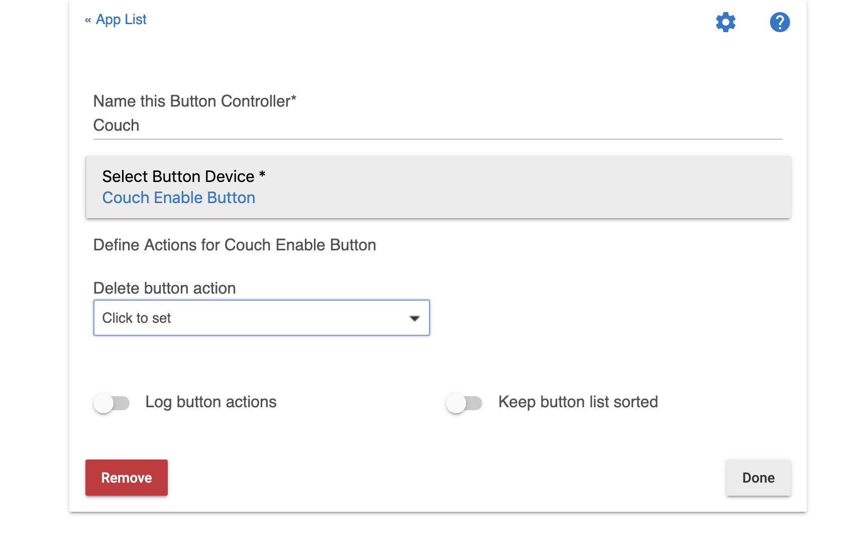

Can't seem to create a the action after selecting the button. The button to add the actions comes up but does nothing when you click on it.
This is what you get after clicking on the "Add a buttion action"

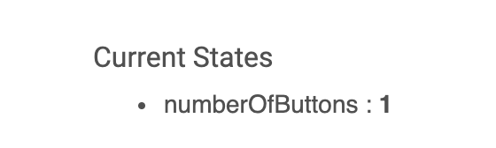

I found the problem, There is a bug in the driver. Go to the device page and hit Save Preferences. You should see this for the device:
00%20PM
Once you do that, BC and RM-4.0 will both work for the device. You will have to remove any pre-existing app instances, they are broken due to no number of buttons when they initialize.
