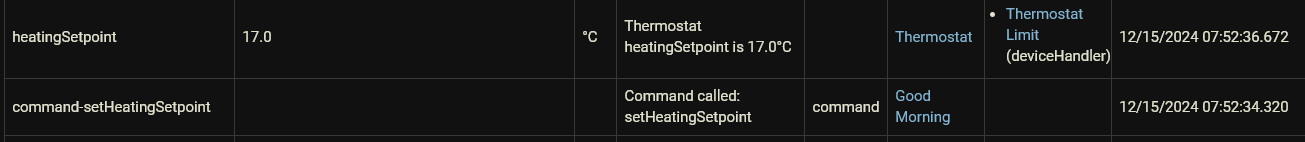

Again this morning, I got up at the temp was set to 17.0 properly as seen in the snippet.
A bit later my wife got up and the Command-SetHeatingSetPoint command was issued but no value arrived in the logs for heatingSetpoint.
This seems to be about 30% of the time. The Evening temp has worked lately but the NIght temp failed 2 nights ago and the furnace woke me up at 3:00 am heating the house.
