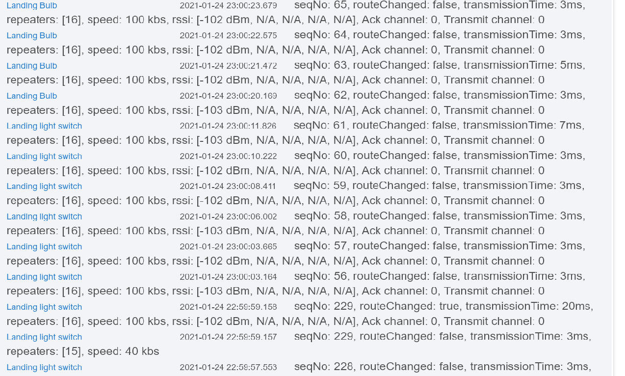

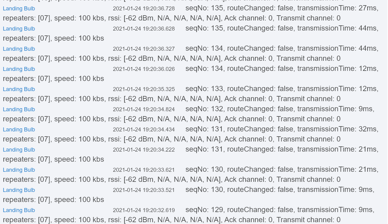

I have 10 of these bulbs working on a C7. I'm actually impressed with how fast and responsive they are. I have them paired no security, so I'm not sure what others are talking about when they say they can't be paired with no security. Maybe a different bulb? but I think they only made just this bulb. I thought i might have trouble with them when I was including them, closest one is about 100' away from the hub and it doesn't even use repeaters when I was testing them, when i first included them. On off lighting quick color change the same. I'm hoping they get more in stock soon. I think I did upgrade the firmware and was using the inovelli driver on the C5 I'm using built in driver on the C7 atm. Who knows maybe I got lucky with all 10
