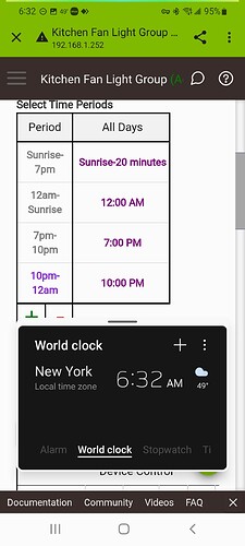

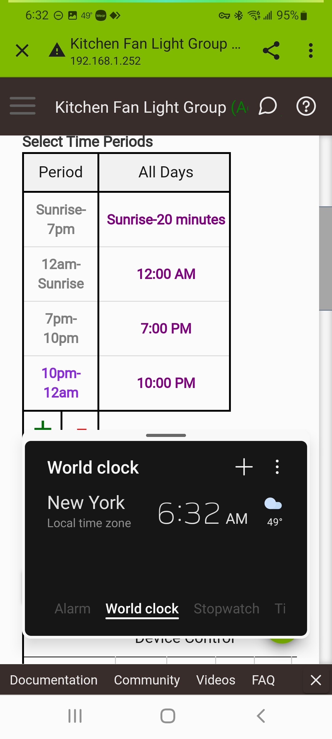

Latest fw x.130. RL isn't registering that it's after 12am. It's still stuck on previous schedule time. Sevetal different groups and it's 6:30am and it's still on the 10pm schedule.
You could give it a period for 12am to Sunrise? Even if nothing is set then.
Please post a screenshot of the main page after midnight, I believe it will show an empty table for no time period defined.

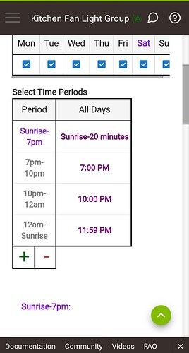

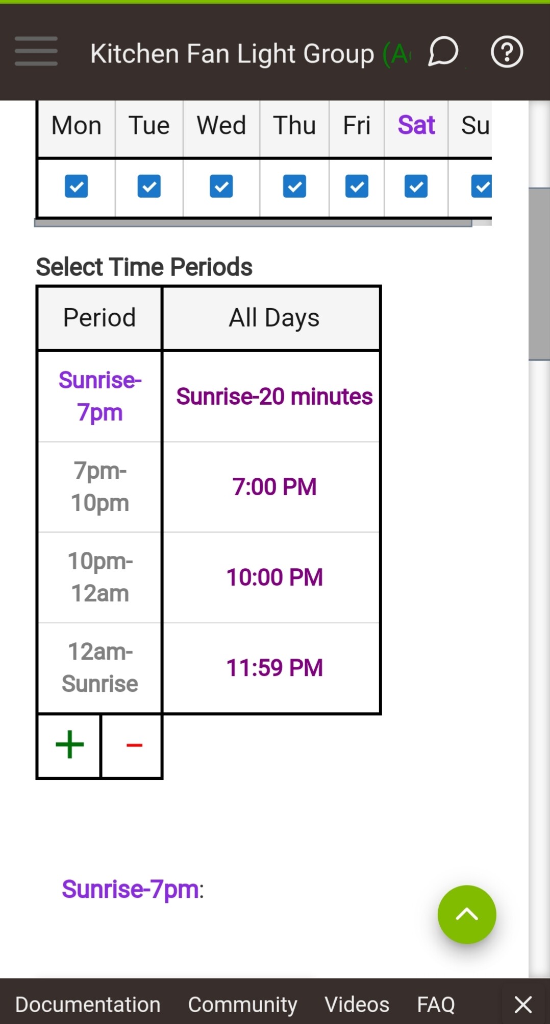

I'm confused. Isnt that what I did? It goes from one table to the next period so from 7pm to 10pm to 12 am to sunrise to 7pm. Tables are set.
Might I add, why is 12am-sunrise ON (Active) if it's set to 12am? Should it be sunrise's table until 7pm? It's current 3:21 in the afternoon est.
Sorry, I missed seeing that you had 12:00 AM to Sunrise.

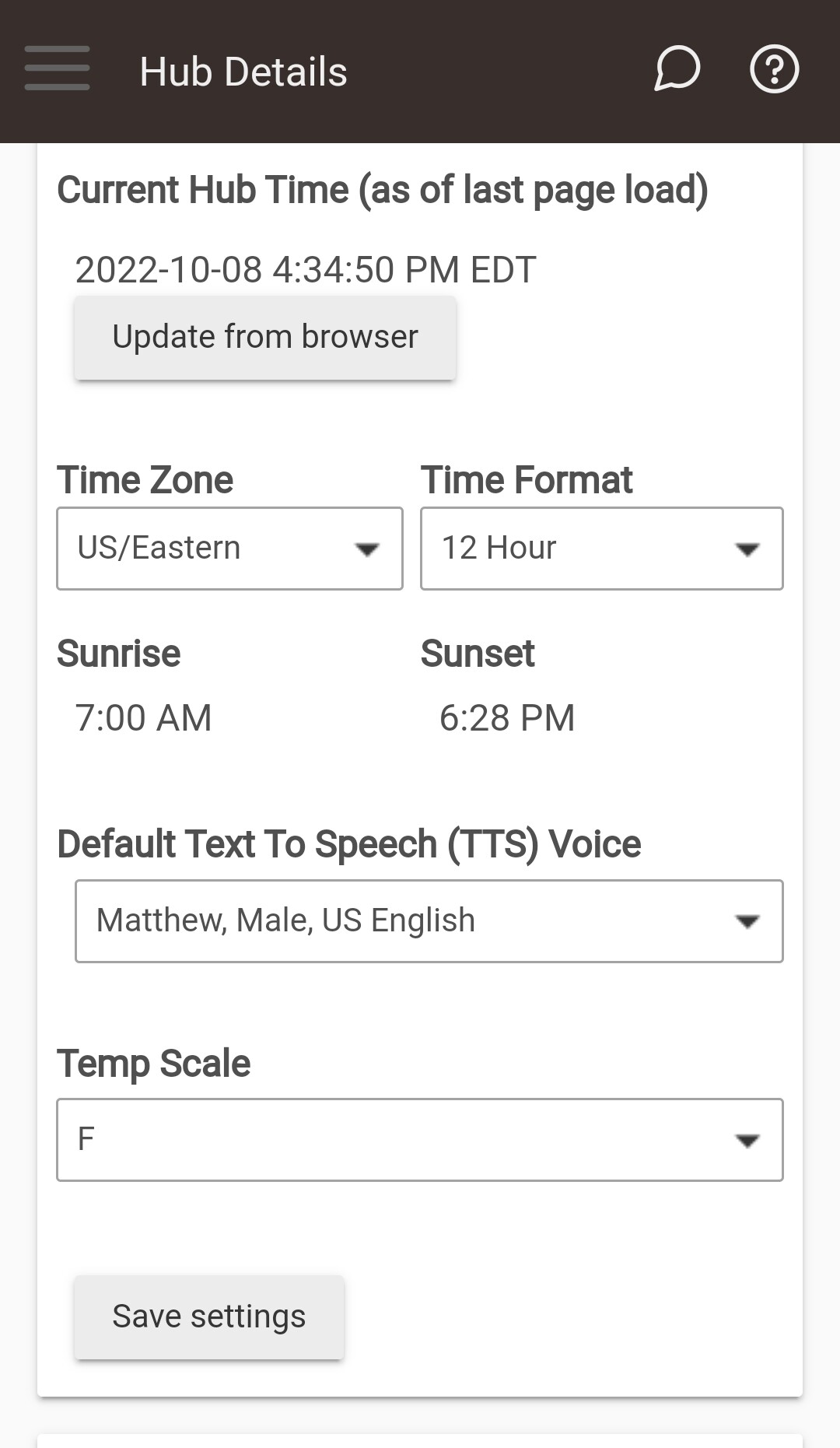

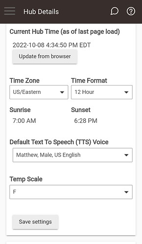

I wonder if your times are messed up. Look at the Settings / Hub Details page, and see if the time zone and time are correct there.
Looks fine.
Definitely bug. I changed 12:00am to 11:59pm. And it set the current active schedule to Sunrise-7pm.
Yep, there's a bug. This actually came up in the context of another app (Thermostat Scheduler) and got fixed there, but not in Room Lights (same code for periods). Bug is for time periods that include 12 AM. Fix for this will be in the next release.
