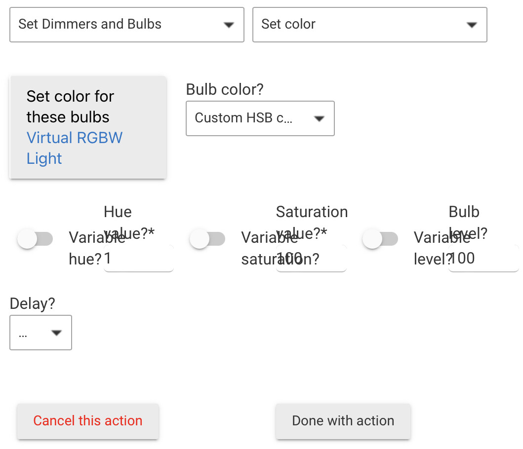

In Rule, setting an action for a bulb to Set Color to a custom HSB color, the option to exit (done editing action) disappears when setting Hue to 0.

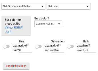

@bravenel, I was able to reproduce this using a the Virtual RGBW Light driver:
I was able to set the same values on the device, so I assume a Hue value of 0 is valid…?
It's a bug. I will get it fixed. 100 and 0 for hue are both red. There is a bug with either Hue or Saturation being 0, fixed for the next release -- but neither value should actually be needed.
