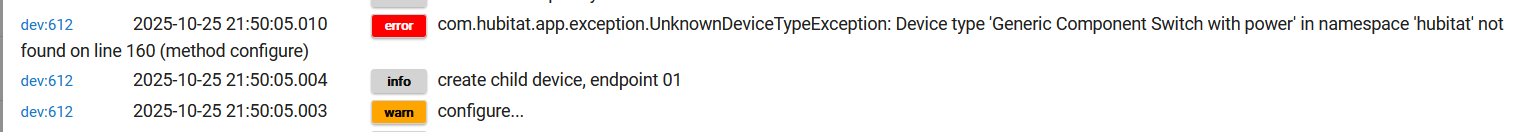

After adding the device, and successfully recognizing the system driver which was release in version 2.4.3.127.
Once you hit the "configure" button, the following error while the driver attempts to create the child:
dev:612 2025-10-25 21:50:05.010 error com.hubitat.app.exception.UnknownDeviceTypeException: Device type 'Generic Component Switch with power' in namespace 'hubitat' not found on line 160 (method configure)
dev:612 2025-10-25 21:50:05.004 info create child device, endpoint 01
dev:612 2025-10-25 21:50:05.003 warn configure...
Thanks, this will be fixed in the next release.
