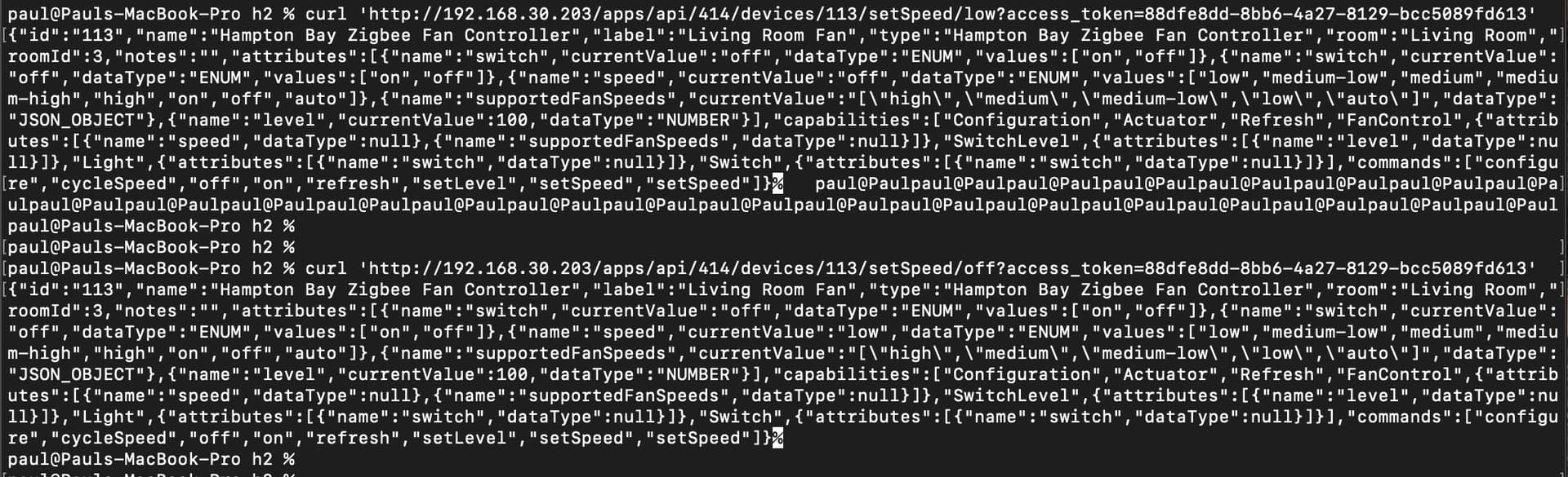

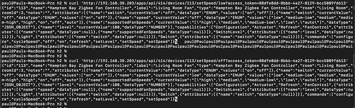

Here I set a fan to low and then off:
Notice in the JSON response that it lists 'off', 'on', and 'medium-high' as available enums:
{"name":"speed","currentValue":"low","dataType":"ENUM","values":["low","medium-low","medium","medium-high","high","on","off","auto"]}

The initial JSON response (which returns quickly) from each of those Maker API commands sometimes shows the {"name":"speed","currentValue":"xxxx" ...} as the previous value, and not the one expected from issuing the command. That can be seen in the above image, as the command to set the speed to 'low' returned a currentValue of 'off', and the command to set the speed to 'off' returned a currentValue of 'low'. Not shown, but subsequent check for the data does show the value being returned correctly, so it appears that the JSON is (sometimes/often?) returned before all the variables are correctly updated.
