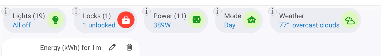

The setup works fine everywhere except on the Home page, Lights button, perhaps because the devices are children of the main device. I can select the correct Switch object into the "Lights" inclusion dialog, but the device does not show in the list of selected devices, and when "ON", the light is not counted in Lights. See photos below.

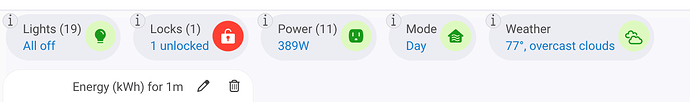

Here are the notices at top of Home Page: Note "Lights...All off"

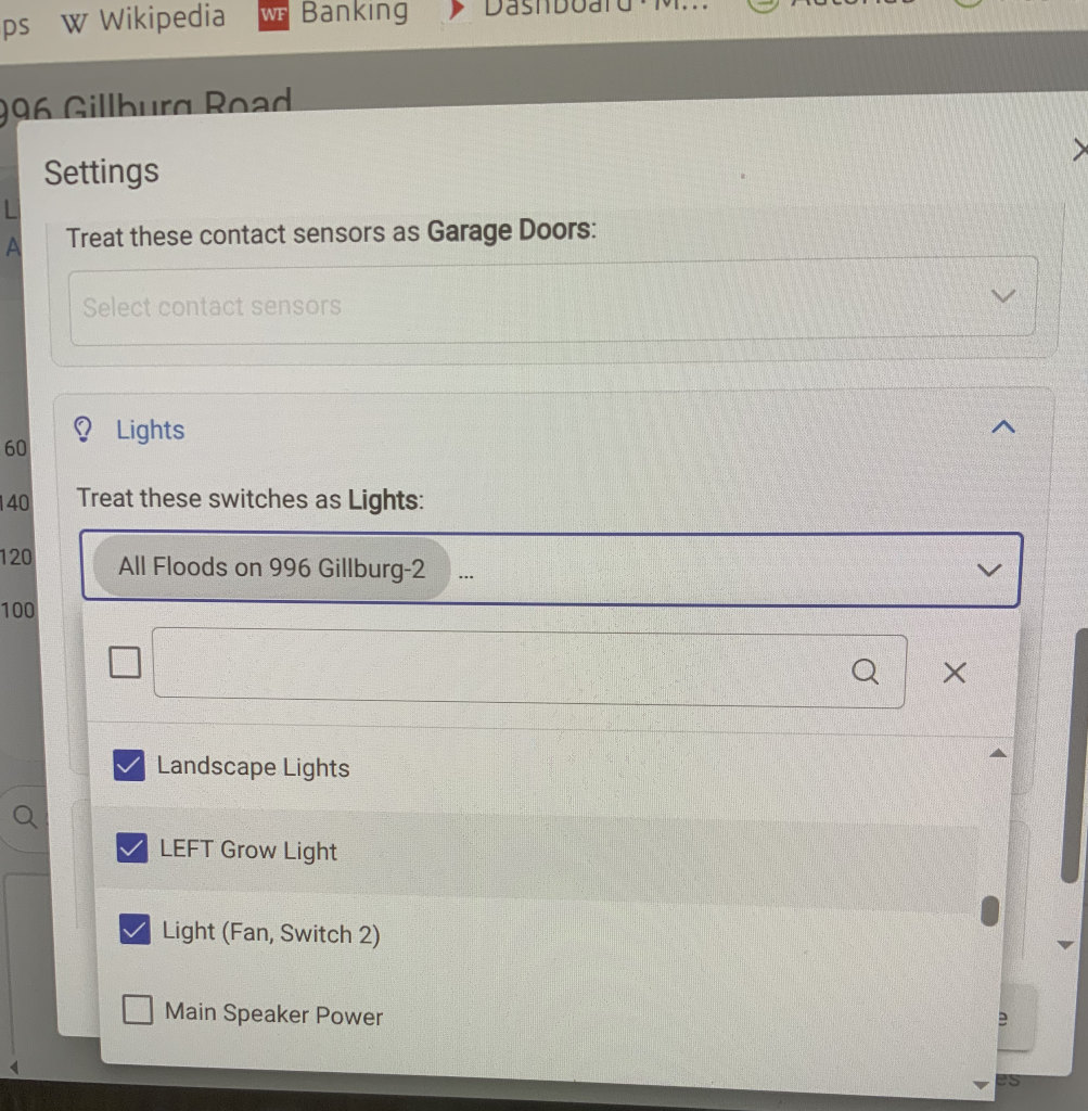

The item "Light (Fan, Switch 2)" is checked, Selected, into "Treat these Switches as Lights"

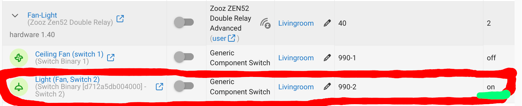

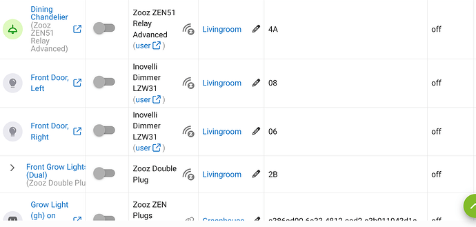

Now, an image of the actual Device list for all devices, with the ZEN52 selected. The parent device is "Fan-Light". The Light in question is encircled, and the present state is underlined. The light is controlled on the second switch, i.e., the second child device.

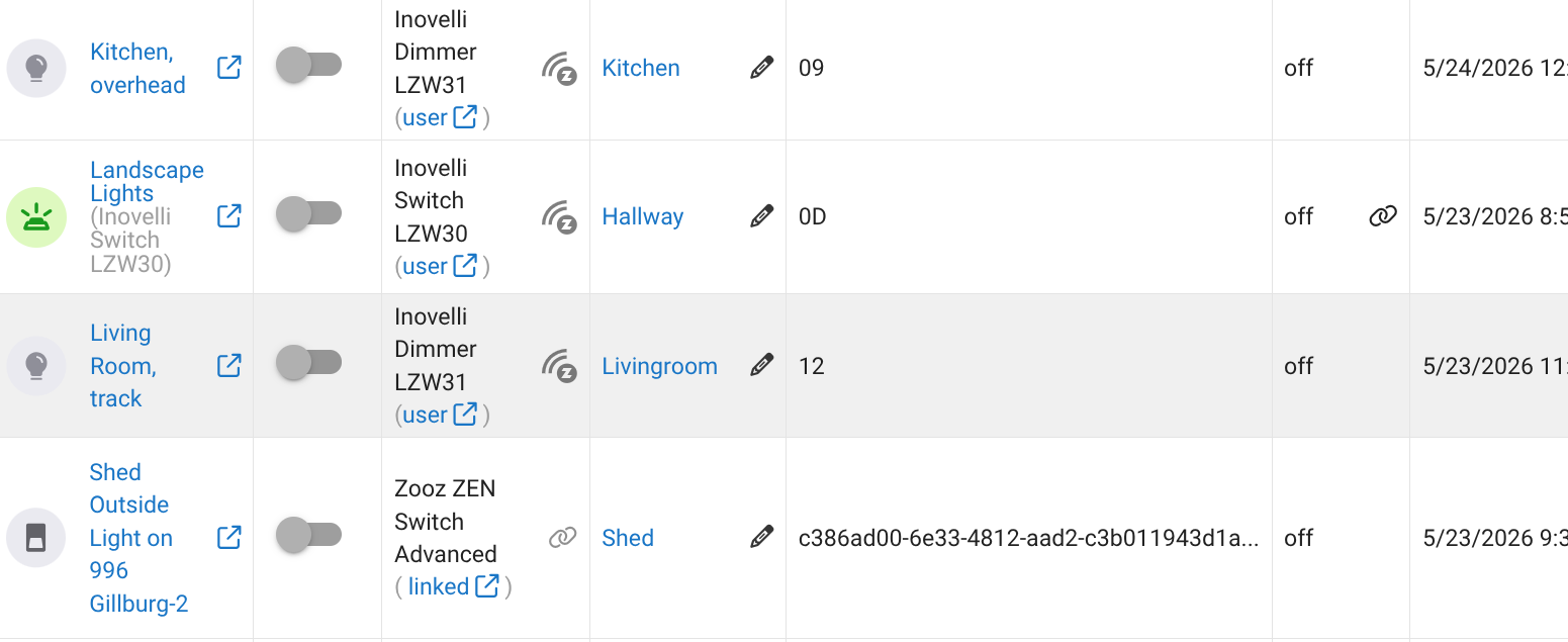

This is a portion of the list of Devices selected as "Lights", by clicking the "Lights" button on Home page. Note that there is no entry for "Fan-Light" (the main device)...
...and there is no entry for "Light (Fan Switch 2)", the second child device, as seen above

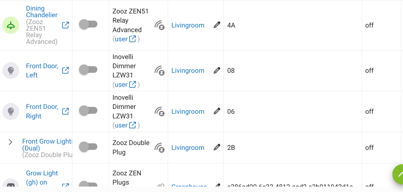

The issue appears to me (in ignorance??) to be related to types of device. I also have a ZEN51, single relay, that controls a chandelier above my dining table. This is also included in "Lights" on the Home page, and it works as expected. The difference seems to perhaps be that the ZEN52 has a parent-child driver appearance, which the ZEN51 does not have. I can't see another difference. I, too, could select the fan as a light, but obviously it is not, so I don't! I did briefly attempt, non scientifically, to see if including the fan in the set would affect anything, and it apparently didn't.
You may see from one of my illustrations that the second, light, switch has a different ID form than the fan, but I don't know why that should matter. For the ZEN51, there is nothing generic. Both devices do, however, use different custom drivers, "Zooz Zen52 Double Relay Advanced", versus "Zooz ZEN51 Relay Advanced"; both drivers by jtp10181.

I do see both switches (fan and light) in the list available with check boxes for the "Light" selection in the dialog (the one that opens when the "Settings" icon at upper right is pressed), but they DO NOT appear in the final list of selected lights when clicking the button on the Home page: i.e., on the Home page, there is a row of buttons across the top, one of which is "Lights" with the total number of assigned light devices selected, and the number that are actually ON. If the button is clicked, a new page shows a list of the associated devices.

In my case, I can select the light or the fan in the setup dialog, but the selected device does not then appear in the affected devices: two different tables, accessed from different menus. The selected light device does not affect the Lights button, whether ON or OFF. All other selected lights DO affect the Lights button.
