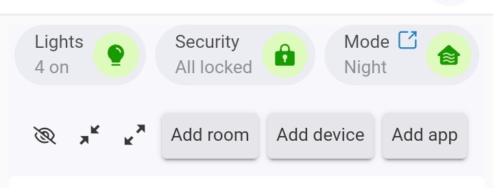

Just noticed on the new UI it shows how many lights are on the main page .. it's shows (4) lights on ... But I have way more then that turned on ... Bug?
Same. Only shows four regardless of how many are actually on.
four lights GIF
I have 6 lights showing as on (on my main hub with devices) and 2 showing on my secondary hub that has no devices attached to it, only apps and their child devices.
Six real lights minus two phantom lights ... ... .. ... 4 LIGHTS!
EDIT: I'm trying to figure out what two devices are being counted as lights on the secondary hub, and it isn't obvious. I have two devices that have dimming capability (to adjust a battery reserve level) and one of those has a child device with dimming capability.
... One of those apps/devices wasn't in use anymore, so I deleted it and now I have only one 'light on'. That most likely means only the parent is counted, and that anything with a dimming capability is counted as a light.
I'm not sure how useful the 'lights on' will be with the variety of virtual devices out there that may use dimming as a capability but aren't illuminating anything.
It would also be nice if clicking on the 'lights on' or 'unlocked' icons would bring up a list of which devices were being tallied, in case you want to turn off or lock the devices.

This was fixed earlier. Sorry I didn't see your post sooner.
