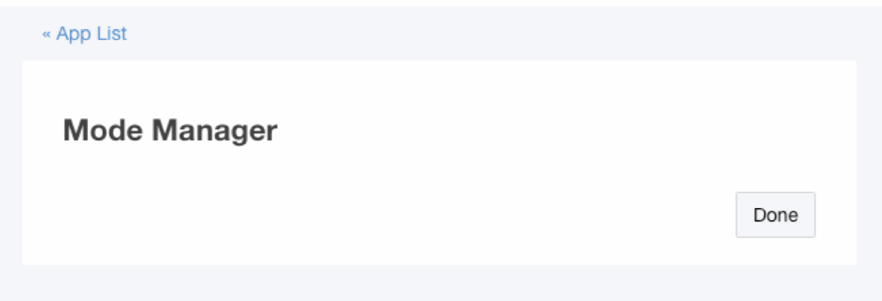

I was trying to use Mode Manager on Mac OS Safari to set up a mode change at a certain time, and after entering in [6] : [00] [AM], on clicking "Done" I was presented with a blank menu:
Clicking "Done" just takes me back to the first Mode Manager menu, with no evidence the time I entered was saved.

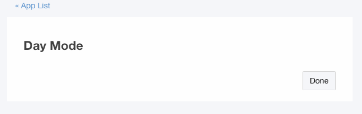

So I went to Rule Machine, started setting up a Trigger rule to make the mode change, was setting up the trigger at a certain time, and also got a blank menu after clicking "Done":
In this case, I click "Done", get that same blank menu with the Done button, click "Done" again, and a third blank menu with no way out except the << App List link.

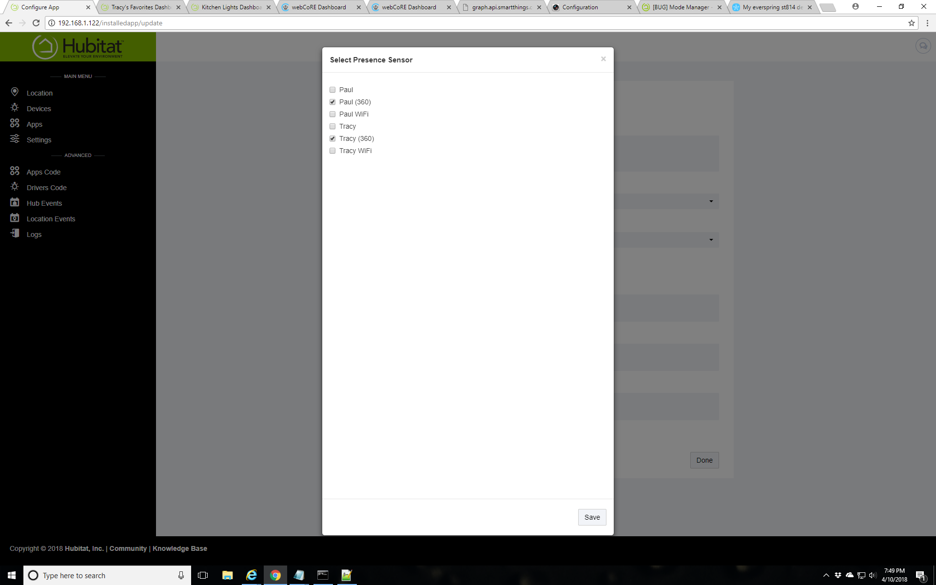

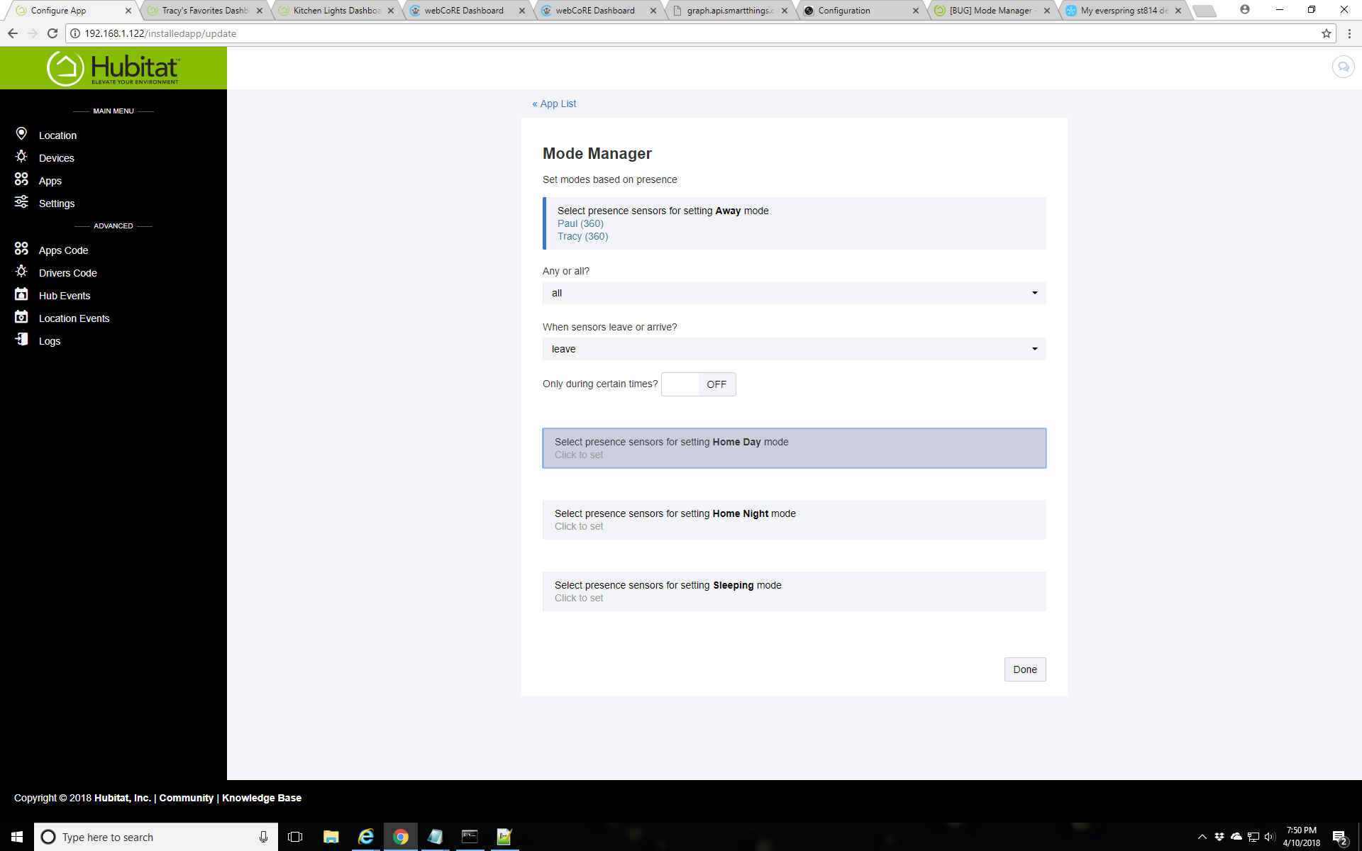

I’m having problems with Mode manager in Safari and in Chrome. I’m connecting with my phone over VPN.
I have four modes (Away, Home Day, Home Night, and Sleeping in that order). I’m trying to set mode based on presence, I am using a virtual presence sensor. I am able to select the presense sensors for away and for sleeping, but not for the Home Day or night modes. I am able to set the mode based on time for Home Day and Home Night. When I select mode based on presnce I get a prompt for the presence sensors, I select the sensors, and then Nothing happens. I’ve rebooted the hub, and I am on the current firmware.
I’ve also uninstalled mode manager and tried again. Any suggestions?
Same from home computer using Chrome browser.
Can you post a screen shot?
Also, post a screen shot for the virtual presence sensor that you cannot select, device details page.
Sure, here's my list. I can select any and click ok, but just sends me back to the menu with nothing selected
