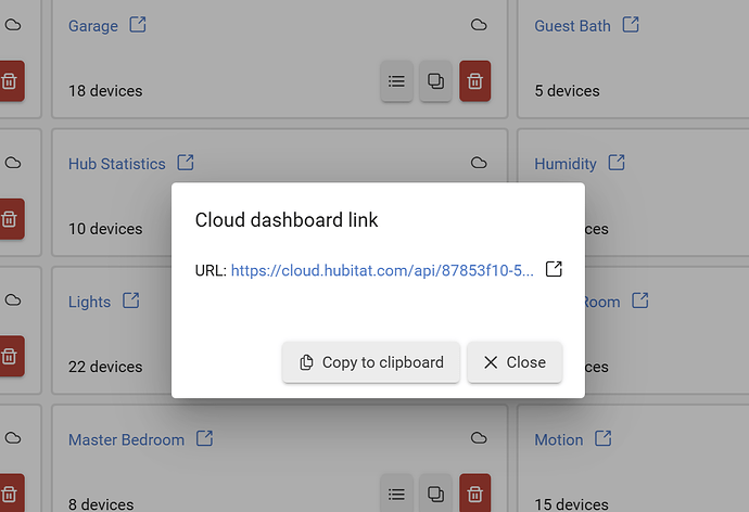

[BUG] legacy dashboard page cloud link generated in new ui is incorrect
the link generated does work and brings up the page but any subsequent dashboard link tiles in the le page bring up this error.
older exiting links that work i have have this section ".../apps/33/dashboard/536?access_toke=xxxx
versus this: .../aps/56/dashboard/536?access_token=xxxx
in addition the access tokens are different in both links.. i will send the complete url to you for test vi pm

no but as i said these are old existing dashboards.. that sounds releated to your seeing the new dash only open on the second click.. and the fact that the cloud dashboard link being generated has a different access token than the old/working dash.
there no longer seems to be a way to get the correct totally working cloud legacy link.. luckilly i had some saved on another laptop..
i stand corrected if you do it the old way.. (as a workaround)...

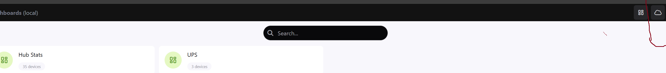

ie click on this link on the dashboard page to go to the old version (dashboard menu page)
then click on the cloud icon on the far right.. the link generated is correct.
i am thinking that the functionality in question is only meant to generate cloud links to the new dashboard versus the old legacy and the fact that it works at all for a legacy dashboard is just a side effect. But then why would new and legacy dashboards both appear on the same page.. it does know which is new versus legacy so it should be able to generate the correct link regardless.
