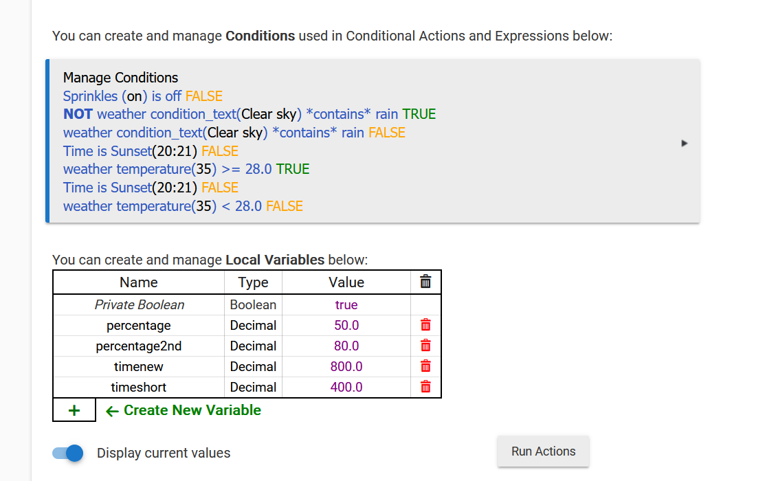

So basically I have a rule for my sprinkles.
It sets the time to 1600sec but 1st zone only gets 50% of the time which means 13 mins.
When the rule triggers automatically everything seems to be working fine but because sometimes the weather has a false positive, I have to manually run the actions.

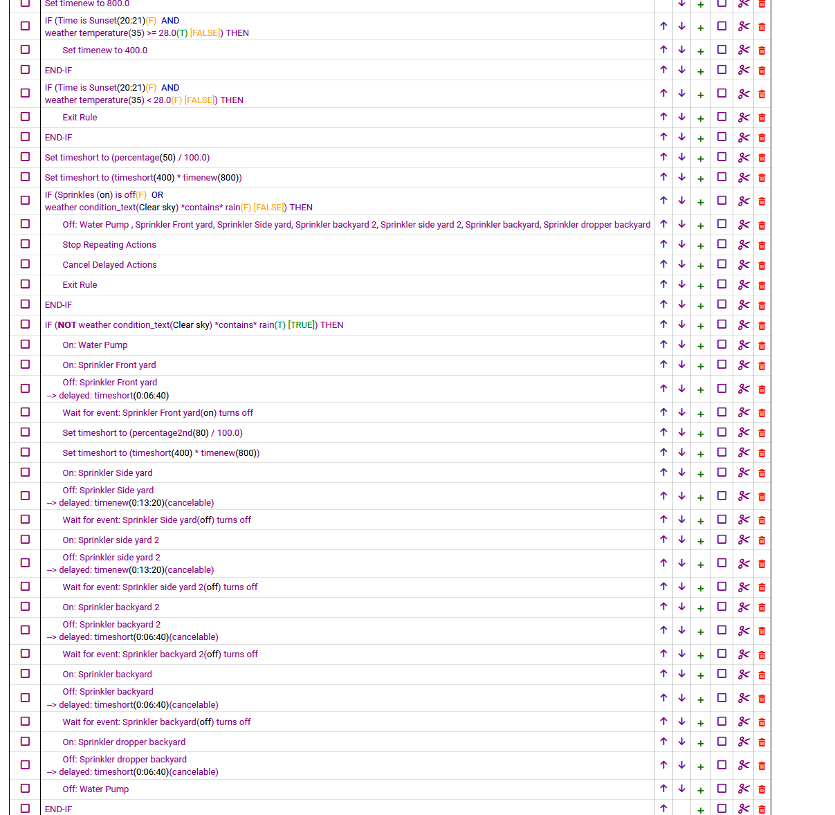

The bug seems to be happening only when manually triggering the rule, please see in screenshot the wait time before turning off the sprinkle is shown correctly (13 mins) but the sprinkle log shows being turned off only after 3 mins instead of 13 mins.
So I'm 99% this is a bug from rule machine since the time is shown correctly but not respected and since is happening only when running the action directly from the rule manually.
If it matters, most of these devices are meshed from a secondary hub and the rule is made on the main hub.

Are you sure it's not Rule Machine working as designed? The delay you circled is not marked as "cancelable" (but your others are), so if your rule triggers twice in the specified time, the "old" delayed action will still be there even after the new one gets scheduled. (This includes "manually" running the rule from Run Rule Actions.) Thus it may, as you described, appear to turn off sooner than expected -- but that's why.
It should also be noted that even with this option enabled, the delay would actually need to be cancelled somehow (a trigger alone doesn't do that). I do see one place in your rule where that could happen. If your other delays are working as expected, that is almost certainly the problem with this one.

I replaced one zone with another some weeks ago so I had to replace them in the rule machine too, somehow I forgot to make it cancelable and now I missed this because I'm 100% 1st time I created the rule triple checked this aspect.
Not even need to test now, is clear to me that this was the problem especially since the hub was not responding so I ran the action several times and this caused the problem. Thanks a lot.
