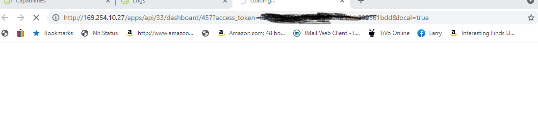

ya it could have restarted .. but the hub itself did not have that address. as i said the hub worked from the std address as always .. the wife plugged the vacuum into a spare strip outlet that was plugged into an ups that had the hub and wifi router on it.. immediately went down as the vacuum uses like 3000 watts.. lol
so maybe the bug is
the hub cannot get an address as router is not up..
assigns tempory ip address and boots up
later hub gets correct address via dchp but DOES NOT update the dashboard links in the UI (somewhere in nvram i assume)?
