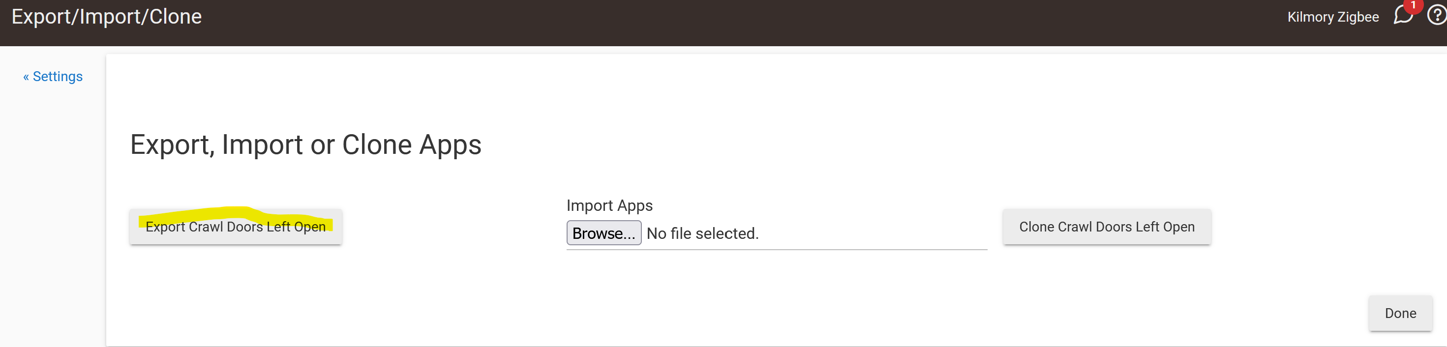

I click the Export/Import/Clone Button from the app status and am taken to the Export app:
Upon clicking the highlighted button with the app name, I am then prompted to reenter the app name:

The main issue I see is there are inconsistencies in the app between having HTML text not having it. When exporting an app without HTML text you are NOT prompted for the file name and the file is of type JSON. If the app does have HTML text within its name, you are prompted for the file name and the file is of type TEXT or sometimes just "file" (at least on Windows PC).
Then when importing the file on a target hub, the Browse button defaults to files of type JSON so you have to know that the file is of type TEXT to find it which creates a bit of confusion:
