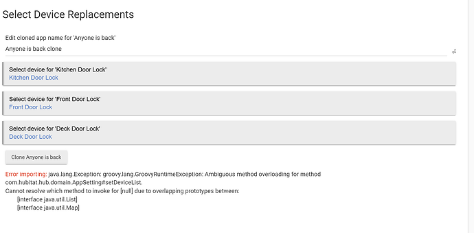

Bug export and clone for rule machine legacy is broken
any clone operation on a rule machine legacy rule generates an error as shown below and generates a broken useless rule with nothing..
in addition export works and generates a text file but when trying to import it the import button is a no op-- ie it does nothing.

This isn't a Rule Machine thing; it's a general thing with the Import/Export/Clone utility. Victor is aware.
For now, re-creating the app is always an option (many of us remember when this was the only way :smiley: ), or you can consider temporarily downgrading to a platform version from before the problem started (probably 2.4.4.146, though I don't see a mention of what platform version you're running, which is always helpful for reports).

FYI, I’m hitting the error in 145, cloning a room lighting.
Yes, you'll see it with any app. It is being looked into:
Noted, fix on the way.
