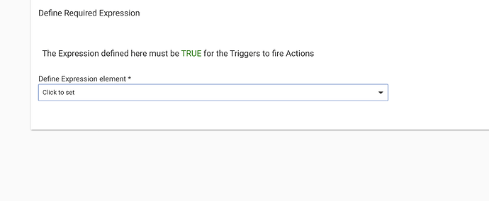

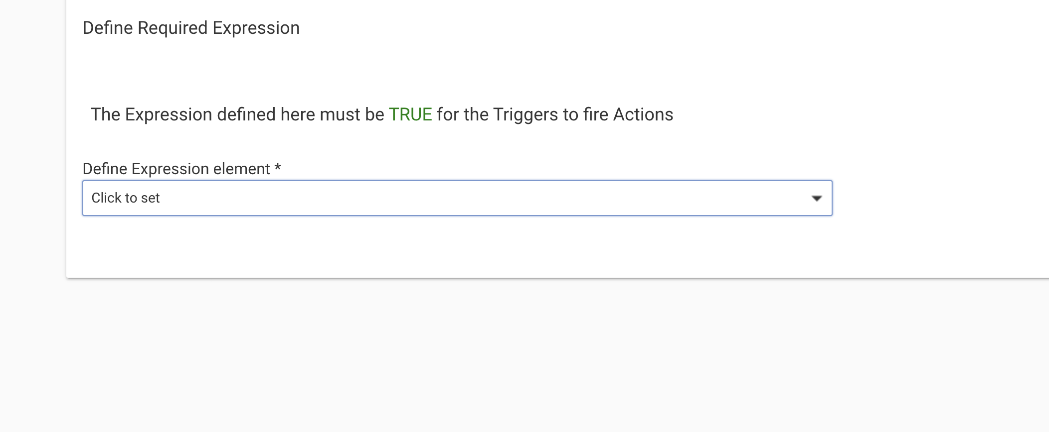

This appears to possibly be a browser issue. The page that first comes up is replaced by the correct page after a brief delay. If you are stuck on that first page, try hitting refresh. Here is what the first (interim) page looks like:
Testing this, I cannot get it to fail, but I do see a delay long enough for me to take that screenshot.
I will say I have seen this as well. I have had a delay long enough that I thought it was stuck, but it eventually continued.
I'm not sure what's going on, although this involves a self generated page refresh, which is where it appears to hangup. If you ever see it again, see if refreshing the page yourself fixes is. Do not use back.

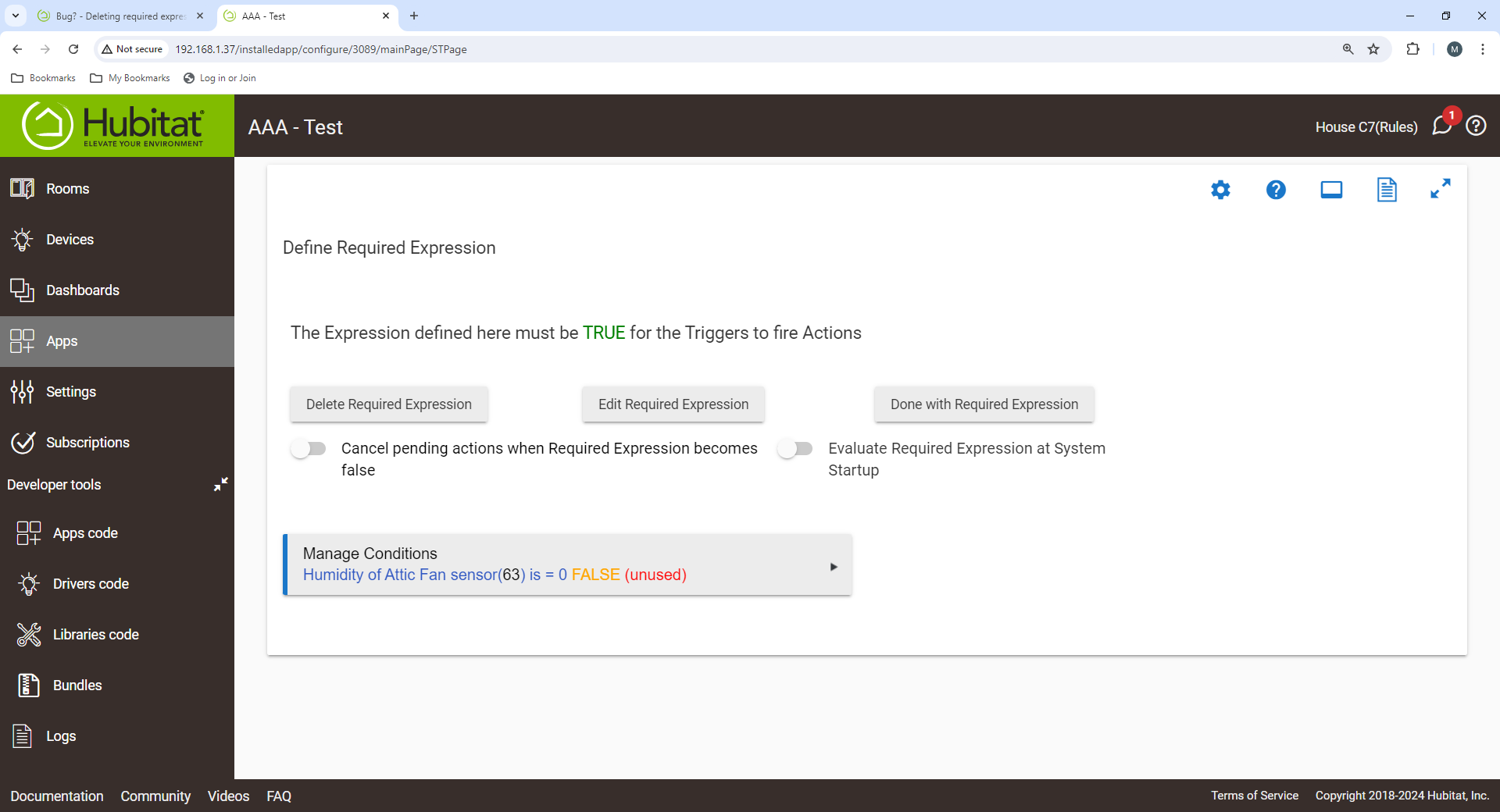

I just did some experiments and if I delete the required expression and do nothing, it takes about 12 seconds for the required expression screen to clear, and then all is well. So you just need to wait.
If you touch the drop down and start building a new condition, or if I refresh the screen then the dropdown to add another required expression will not clear. Then it starts doing weird stuff.

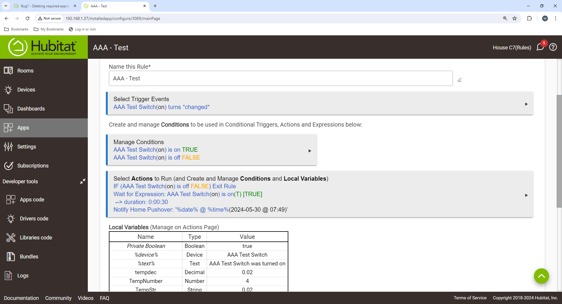

This is the rule I used for testing, just a simple test rule I had for testing something in pushover I was having issues with some time ago.

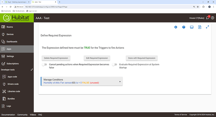

I added a bogus required expression and then deleted it.

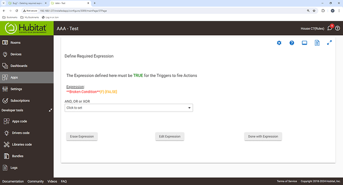

If I delete the required expression and then started building another condition instead of waiting for the screen to clear, then after I build the new expression and say I am done it comes back to a screen with the required expression deleted. There is no option to create another required expression, however. If I refresh the screen it comes back normal with the required expression slider.
If I try and build a new required expression after the refresh I get this. No expression is listed but I have the option to edit something. If I click edit expression it just shows a broken expression.
