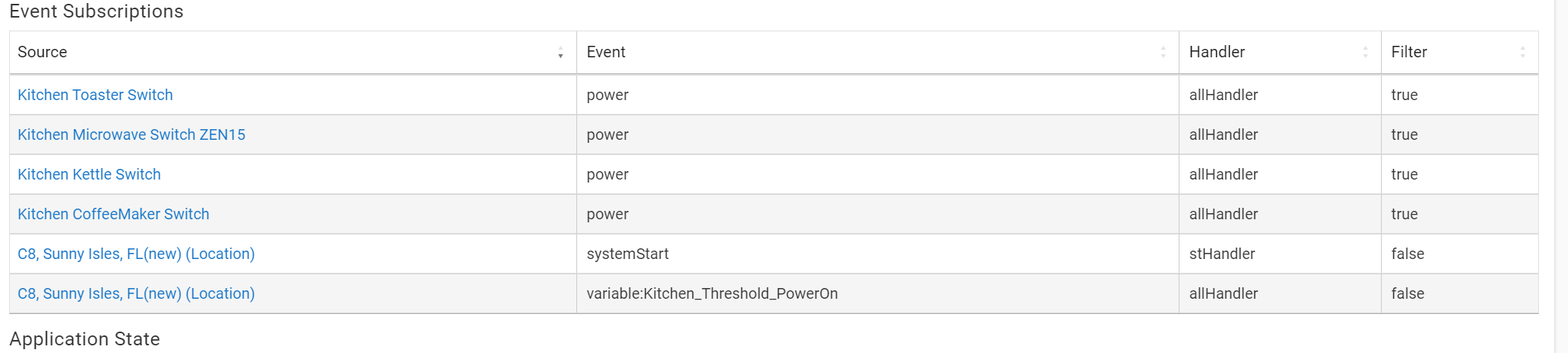

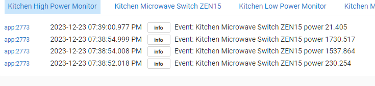

There is a subscription for all 4 outlets:

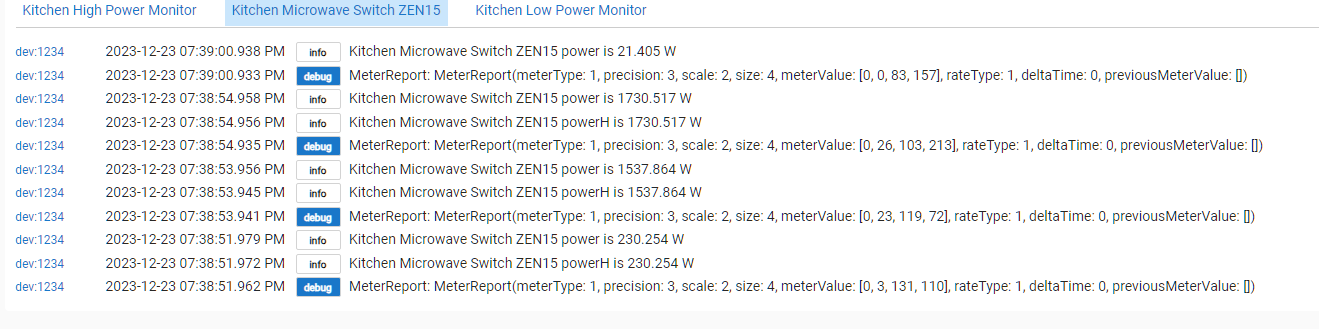

Enabled logs for the ZEN15 itself. Here is one:
And here is an app log after ZEN15 log was enabled:
It looks like app detected an events from ZEN15 but did not execute any Actions.

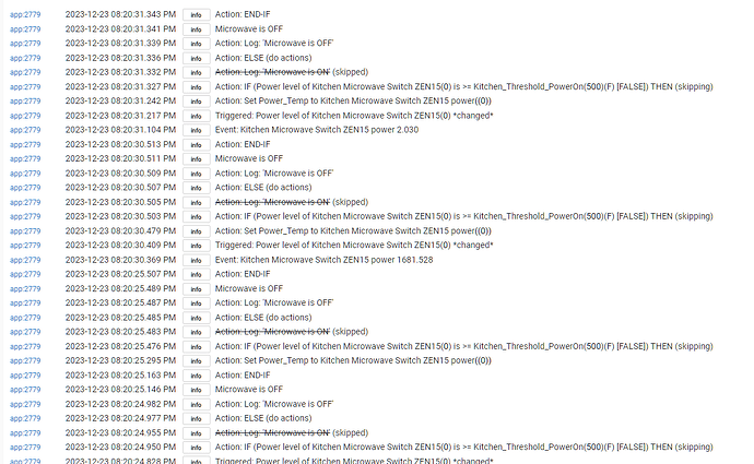

Here is a simple ZEN15 test rule:

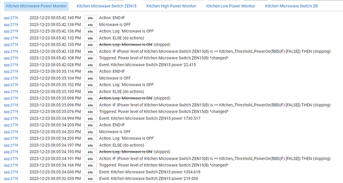

And here is a log which does not make any sense:
Reported Event is well above the comparison threshold but Trigger and IF
is always seeing 0.
But my rule in question is even worse. It sees an event but ignores all Actions.

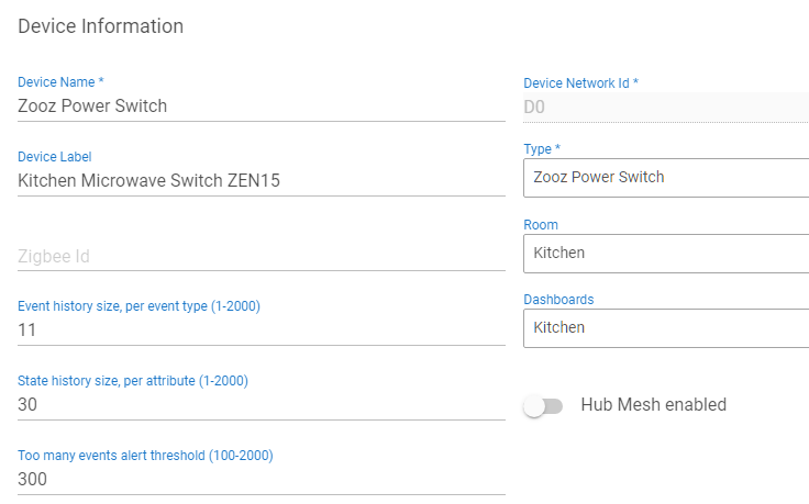

What driver is this? It's interesting that %value% is not set in the rule.
I guess this is built-in "Zooz Power Switch" driver, it was assigned automatically:

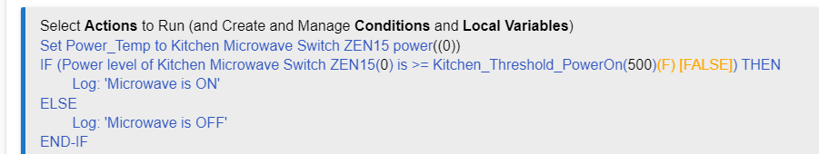

Sounds like a case. I modified a test rule to assign power value to temp variable:
and this var assigned to 0:
Actually last reported Event was 2.030
And %value% is assigned to the same number:
