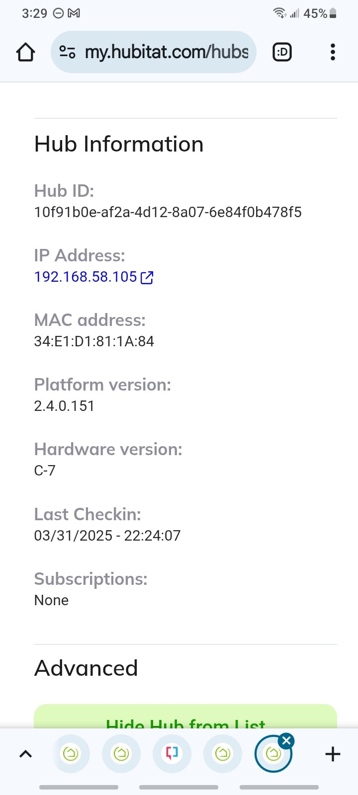

  • findmyhub.hubitat.com thinks it is finding a hub and gives an IP, but cannot connect to web UI or diag tool.

That could be a stale IP from the last time it connected possibly, if you are logged into your account on that page. To know for sure you would have to log into the router and check the devices list, see if there is anything using the IP.

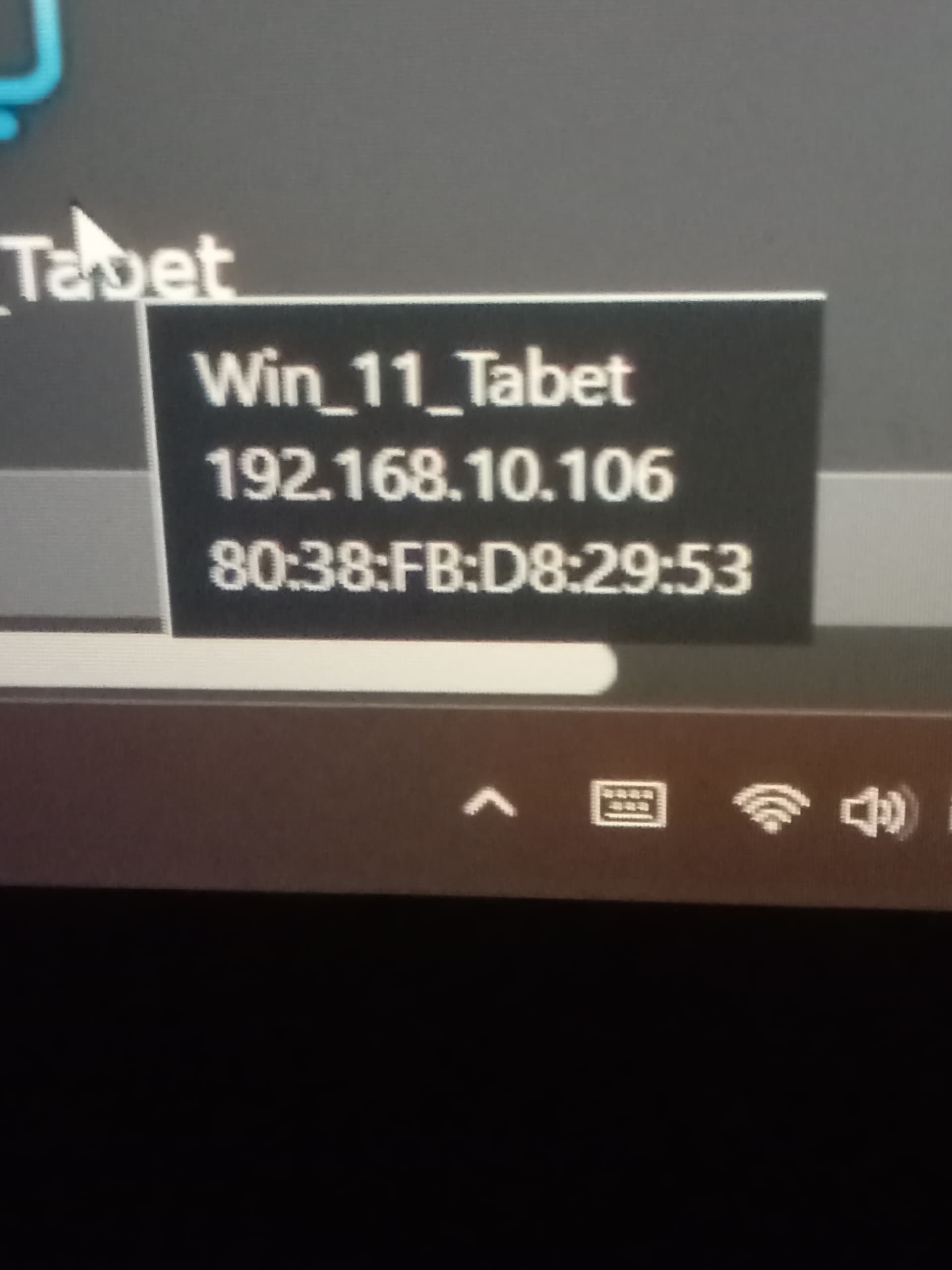

Another possibility is that the device you are connecting from is on a different LAN somehow. One way to check that is the IP of the device, it should start the same (192.168.10.xxx). Not sure where to find it exactly on Android, should be in the Wifi settings area somewhere.

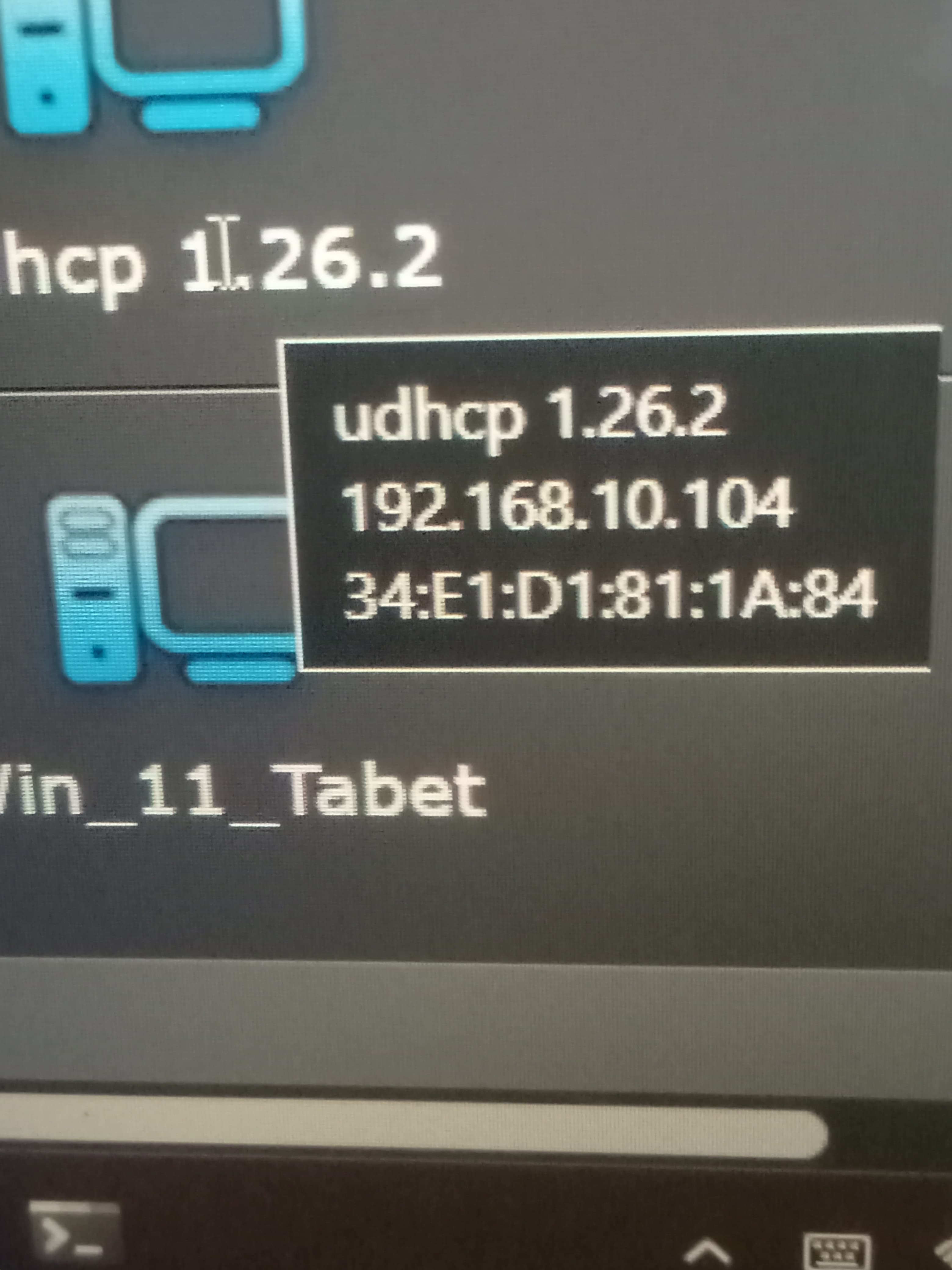

In the router, it does identify the hub as udhcp 1.26.2

Did you verify the IP shown in the router is the same one you are trying to ping / connect to on port 8081? Trust the router more than the findmyhub page.
Also still wanted you to verify this. What is IP of PC/Laptop being used?
In the router, i can see the device but nitvthecip address for the hub, but the ip address for the router is 192.168 10.1 and the ip address of ghe pc is 182.168.10.106
One more thing, it was working for a few days before (after @kkossev helped with the drivers), it crashed and now the reset process that actually changed the lights, but it still goes to the blue light after resetting. Is there another way to reset the hub?
Now i was able to finally see the ip address in the router for the hub. The ip address displayed is 192.168.10.104 for the hub.
Pc 192.168.10.106
So, you were rightthe ip address found with find my hubs does.
When i go to the ip address the hub has, 192.168.10.104 will not load
192.168.10.104:8081 will not load
I can ping 192.168.10.104 without problems.

Just to confirm, when you ping it from a PC, the MAC address returned from an ARP lookup, matches the MAC address found in "findmyhub" page. Just want to make sure you pinging the proper device.
Also, can you ping continuously, then remove ethernet cable, see the pings drop, and then reconnect, and see the pings succeed again.
If you're really pinging the hub, and have confirmed the proper IP, and have link level connectivity (ping), then the :8081 diag page should work. If not, and you've done a reset, I think it's time for some new HW.
