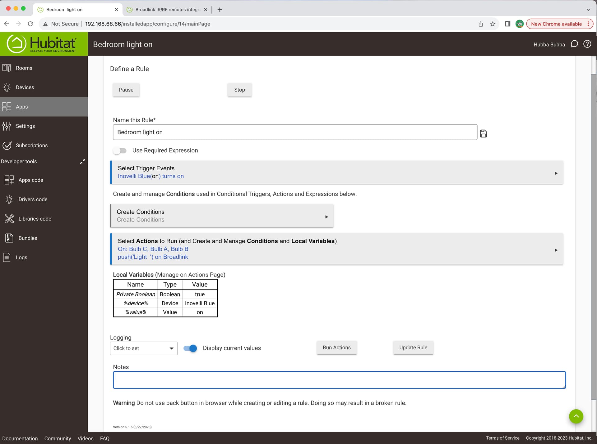

What does the logic in the Rule Machine rule look like?

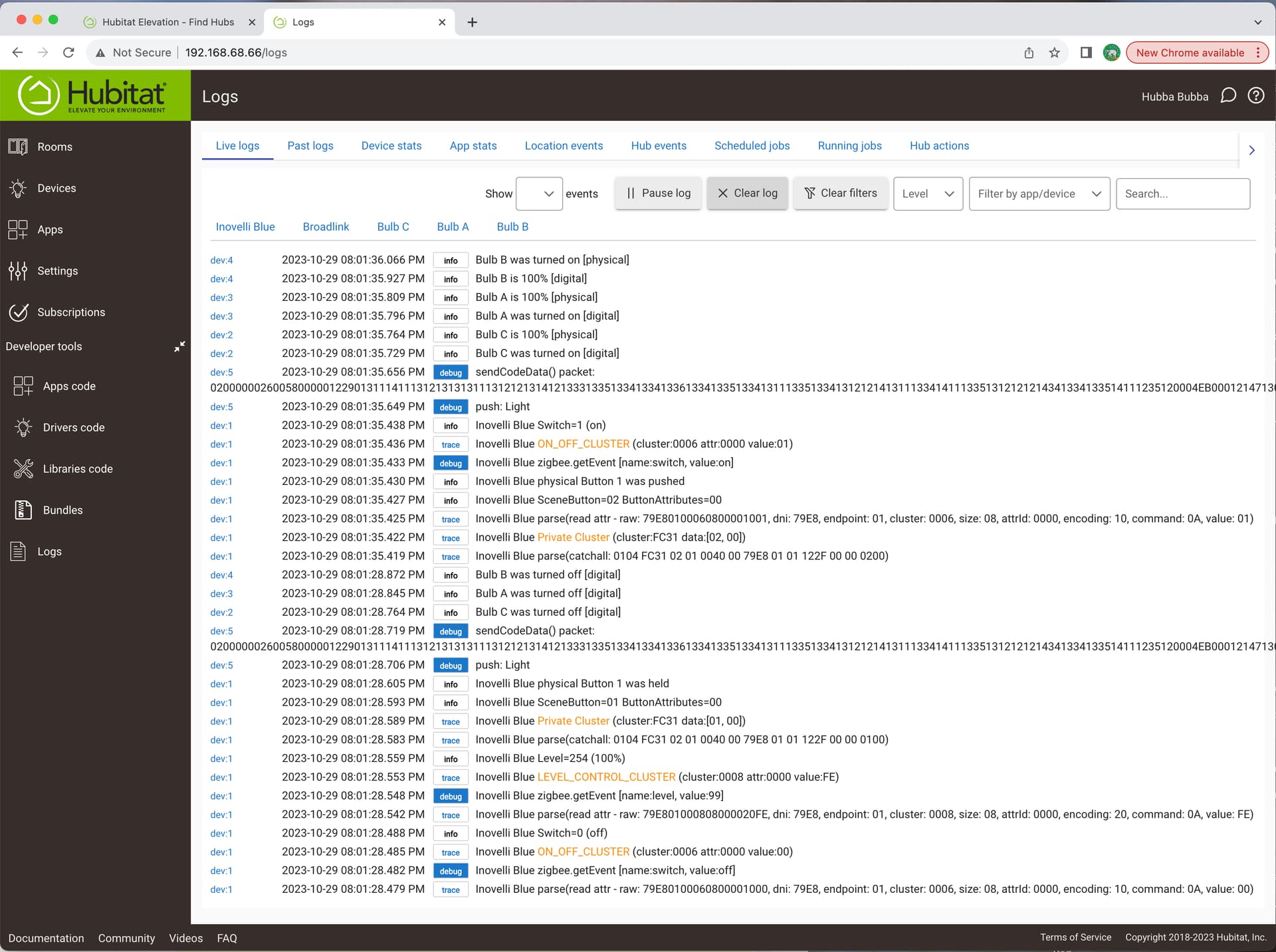

just flipped the inovelli to off and then back on. This is what the logs look like. Seems quite busy. Maybe I am doing something wrong there.
Nothing is jumping out at me, and as tomw said earlier, it looks like the integration here is working properly overall.

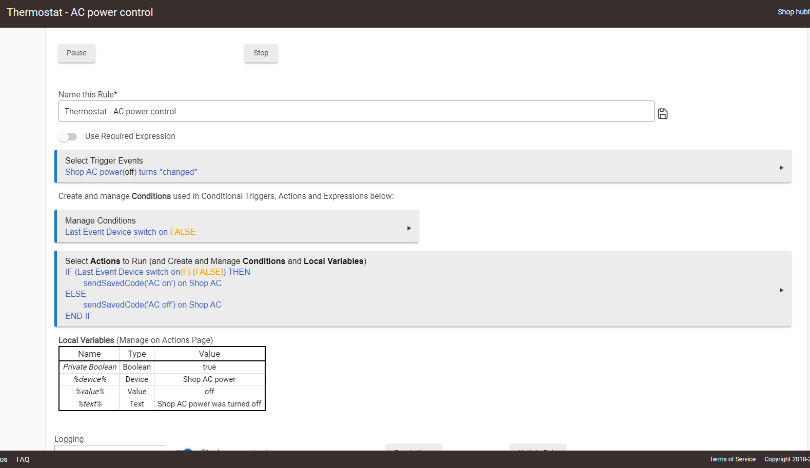

I use the BL to control an old Delonghi unit in the office of my shop. All I can do is turn it on and off. I created a virtual power switch and when that switch is turned on and off it calls the codes I learned and saved. Shop AC is the BL remote device, Shop AC Power is the virtual switch. I use a virtual thermostat to monitor the temp and turn the switch on and off when AC is needed.

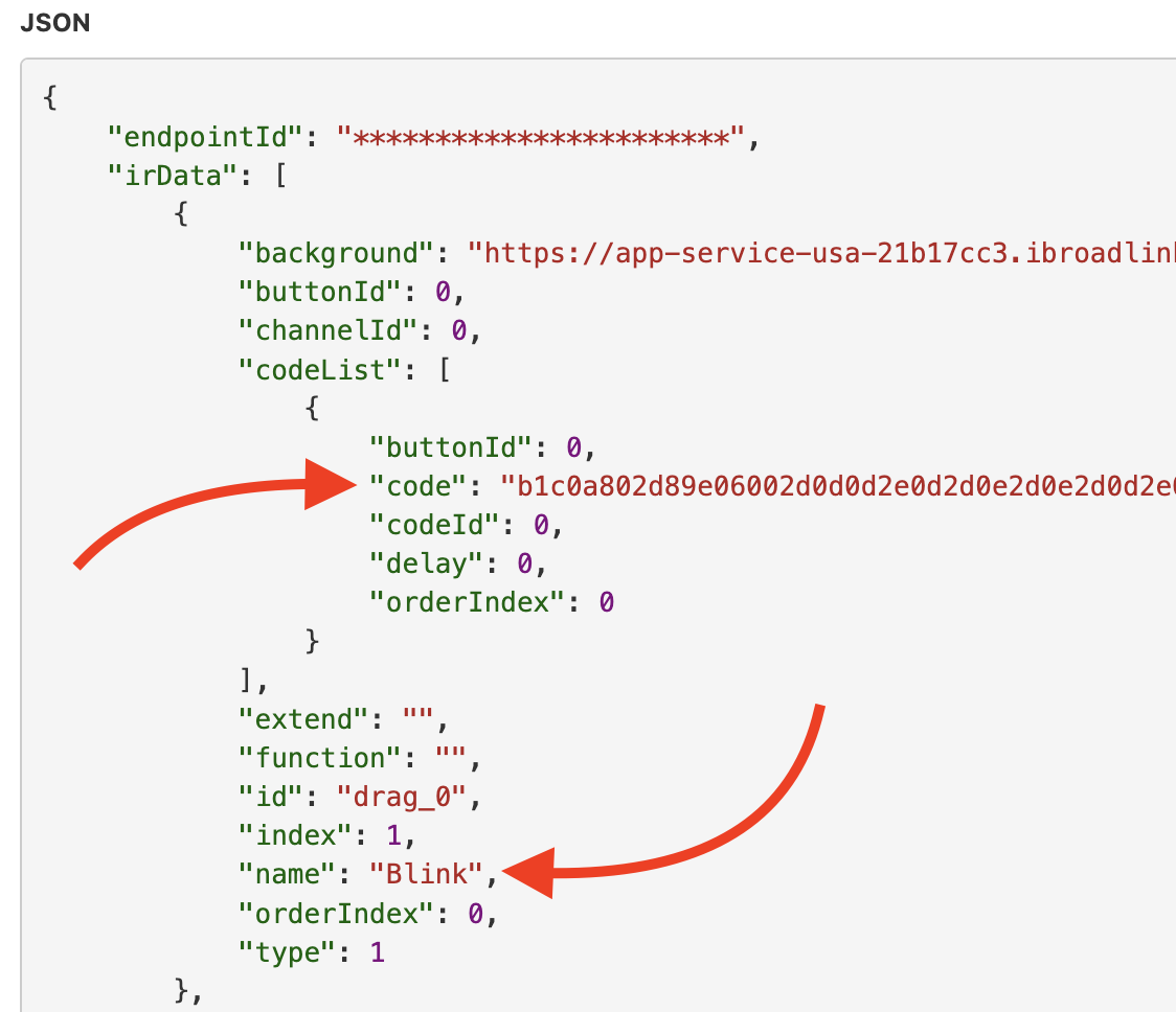

  13. In the mitmweb browser window on your computer, look for a POST request ending in ircode/add (same for IR or RF devices). If you do not see it, try editing another command name.
  14. Click the ircode/add request and take a look at the request data which should show all of the commands for that device.
