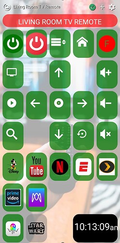

Hello @Martin_P , I am trying to do a similar thing with creating a TV remote control on a dashboard. Could you advise how you saved the channels and created the buttons to execute sending out the various codes saved into the Broadlink App?
Not @Martin_P, but I have set up multiple remote dashboards to control TV systems. First step is to create a virtual button device but assign it as many buttons as you want. Don't create a virtual button for each action or will you will end up with a ton of devices.
Next, using either Rule Manager or Button Controller, setup the action that you want for each button number of that Virtual Button device. I use Node Red for my automations so I am not real familiar using Rule Machine or Button Controller but know it can be done that way.
Finally, create a dashboard with only that Virtual Button device. Then, add a button tile on dashboard for each command you need. You will be given the option of which button of that Virtual Device gets pushed, held, or released when the button tile is pushed on dashboard.
