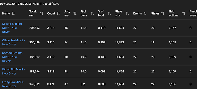

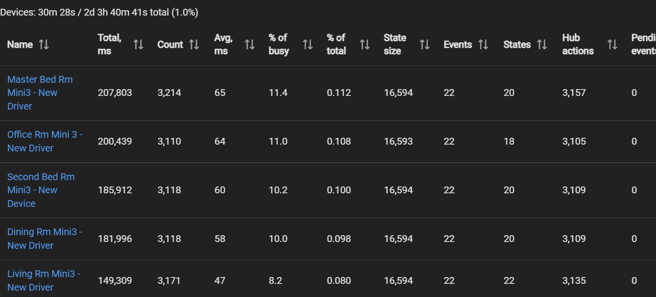

My RM3 Minis seem to be using a lot of cpu doing "hub actions" although the actual number of real evens remains low.
Hey @arnb, I'm not sure what this "Hub actions" category is based on, since there doesn't appear to be more documentation from Hubitat on what it means.
However, from a CPU perspective I'd focus more on the "% of total" than "% of busy". 0.1% utilization out of total uptime does not seem to be a cause for concern, regardless of the hub action count.
Are you seeing any performance issues with your hub, or are you just curious about these numbers?
Mostly curious about the devices using so much CPU time when they are doing nothing except Hub Actions.

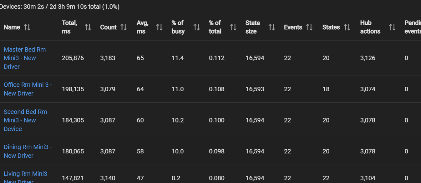

Since I originally posted counts have gone up. For example the Master Bed rm went from 205,876ms to 207,803ms while device events was unchanged. I don't remember this happening when I tested this back when.
There's a scheduled task that does the hearbeat ping every 60 seconds to keep the Broadlink device from rebooting. Other than that, the driver is totally idle if you aren't executing commands.
I guess the ~31 pings between your screenshots may have taken up to a couple of seconds of CPU time in total. Doesn't seem too bad. :wink:

FWIW I disabled the heartbeat pings and as expected the CPU time plummeted.
Kindly add a preference allowing for the ping to be disabled.
This driver hasn't been updated very frequently lately, so hopefully it isn't too onerous for you to manage the code tweak to remove that line on your local installation.
I'll consider adding that whenever I make my next update, but I can't promise that I'll prioritize it. The driver page is already painfully cluttered with commands and preferences, and regardless I think some perspective is necessary.
It may feel good to see those types of numbers go down, but a device utilizing 0.1% of the CPU and 1% utilization across all devices in your hub seems like a pretty healthy operational state to be in.
That was a simple comment of the runIn(60, ping) at lines 256 and 375
