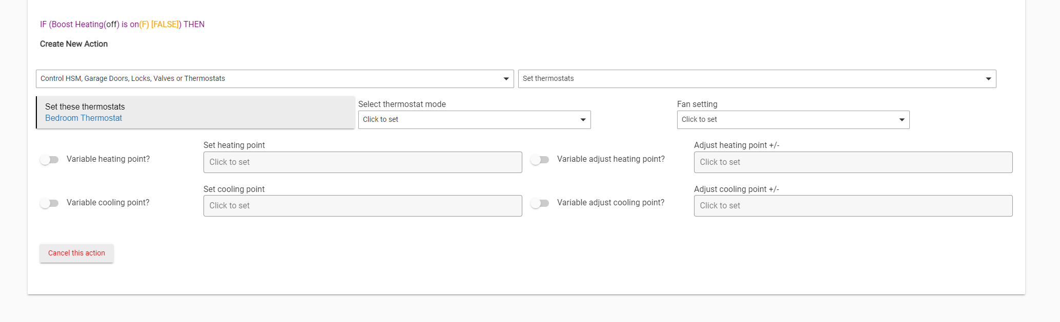

Evening, i'm trying to write a rule where i boost my neostat thermostats for an hour then have them set back to their pre programmed mode (done via the neo hub). I've gone to write this and got stuck on thermostat age as i dont know what i should be selecting to turn it on then back off with the else statement in rm. Can anyone point me in the right direction? Thanks

it was more what do i select on this screen really to turn the heating on and set the temperature then after an hour default back to the stats auto mode
On that screen, I would set the thermostat mode to “Heat”. Then add a “Wait for event” -> elapsed time 1 hour, then from the “Set Thermostat” screen, Select thermostat mode: Auto.
