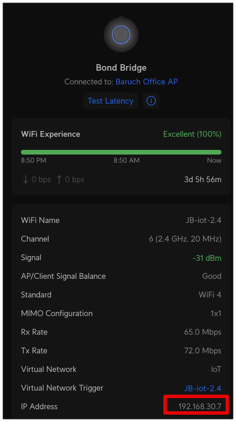

The problem is when I add the integration (the setup screen looks the same it always did, not sure if it means it's not a new version), I don't see my Bond bridges. I know for sure they are online and on the same network, they are just not in the list and "Refresh" doesn't help.
I see no bond bridges or devices connected to the bridges in the Devices list (looks like I've deleted them all successfully).

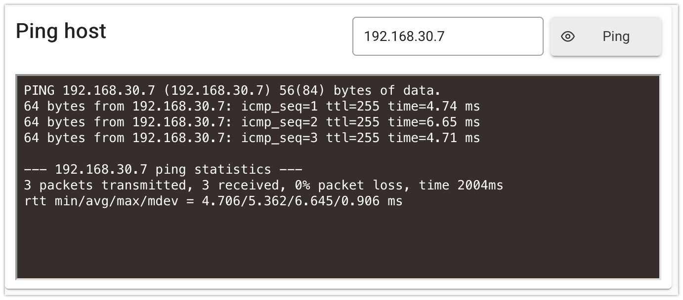

Yeah, that makes sense. The hub most definitely can see the bridges, as the legacy app communicated with them as of yesterday.
Update: looks like it can reach it (see screenshots)
