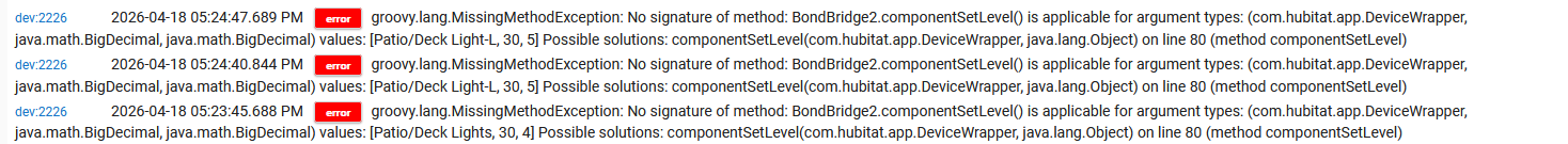

Also: When I try the "Set Level" command and put in a duration, I get this (it seems to work fine if I leave the duration out):

  2. Code to either handle the "Duration" or remove the field (I believe the error indicates that the driver simply doesn't have a routine built to handle duration--even though that field is defined for the device).

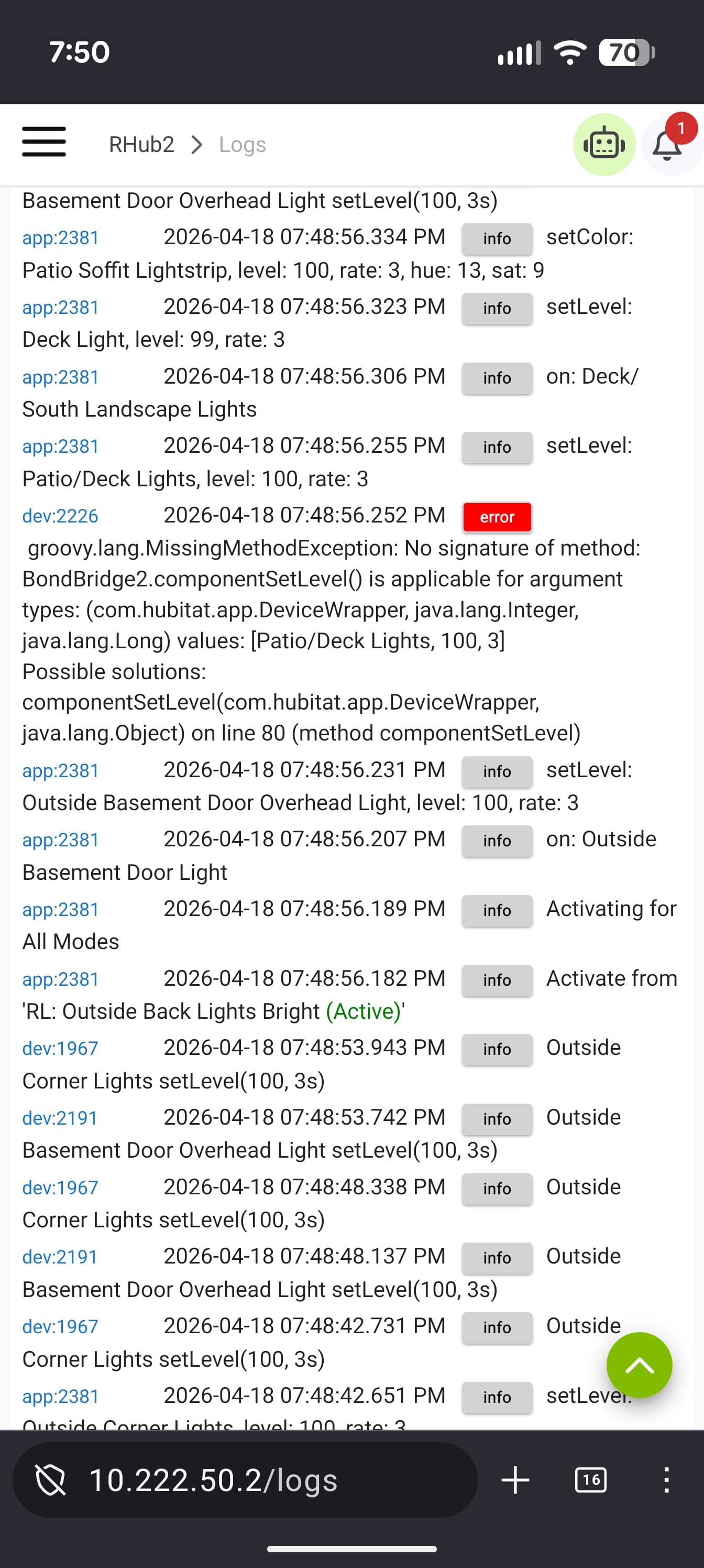

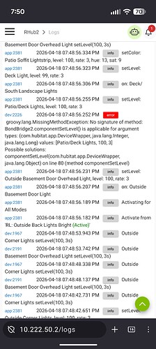

And, there's a fatal error when Room Lighting tries to set them:
