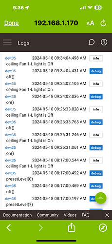

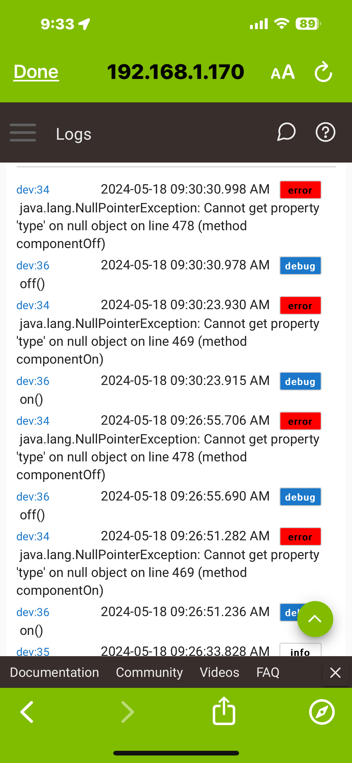

On the parent Bond hub device that got created, turn on debug logging.
Lets see what the logs looks like for the working fan vs the not working one.
Post a screenshot please.
The first is the one working the second pic non working. Thanks
On the main Bod device, can you copy and paste (as text) the "devices" State Variable. It looks like something is possibly missing from there.
