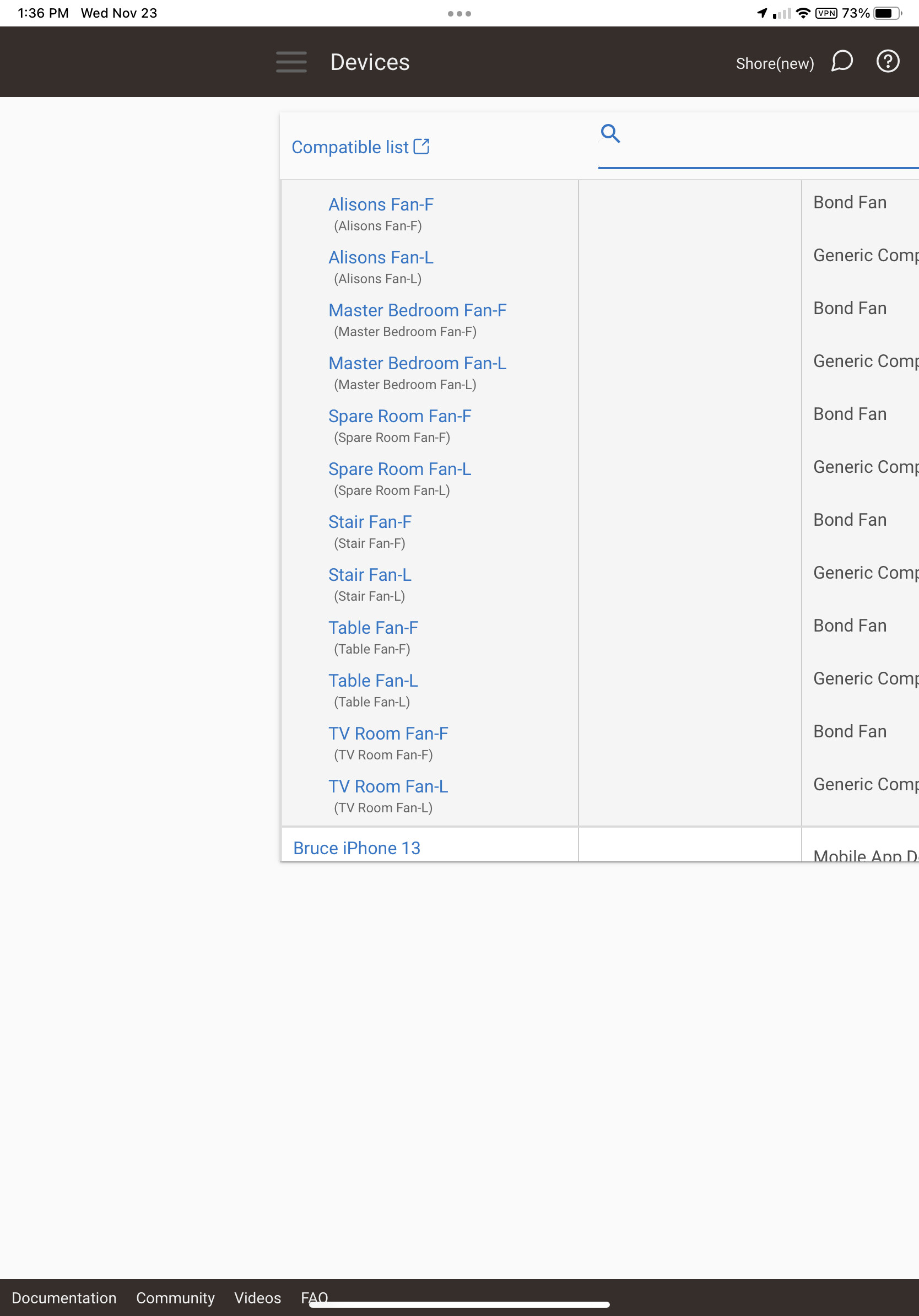

The Table Fan, TV Room Fan and the Stair Fan have the up/down lights that are dimmable
I installed the latest update and I still only see one light. @bcopeland @danabw . I still only see one child device. See below. Up/down include stair, table ans tv fans.

Have you gone to the Bond Untegration parent Device page and clicked on configure?
That resulted in all my devices filling in.
Yes I have
Turn on debug logging for the parent Bond Integration device, open up a log window, and then hit Configure. Post results from logs of that command here for @bcopeland to look at.
Results for @bcopeland @danabw
