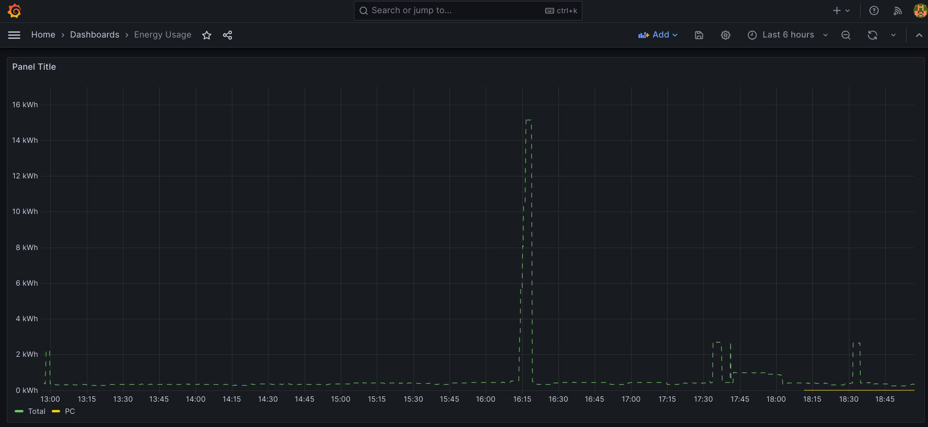

Thanks to this amazing mqtt-exporter creator/developer, YAMA is now supported by it, and all the metrics can be exported to prometheus :tada:
mqtt_power{topic="hubitat_home-hub_pc power switch"} 7.0
# HELP mqtt_voltage metric generated from MQTT message.
# TYPE mqtt_voltage gauge
mqtt_voltage{topic="hubitat_home-hub_pc power switch"} 250.0
# HELP mqtt_energy metric generated from MQTT message.
# TYPE mqtt_energy gauge
The result of that:
