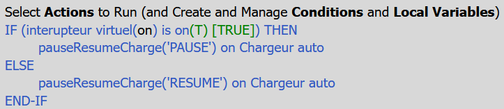

Can anybody tell me how under RM to control the Wallbox ?
I want to do simple Pause / Resume under Rule Machine,
First issue, I do not see a charger device type I see the Wallbox device under the 'Power Meter' category. Under that category, to send command to it, I need to use the custom command send PauseResume, but doing this It ask me for a parameters type, and a parameters to be sent. Is that the right way ? If yes where can I get the info for these ?
I can control easily the Wallbox under Devices and I see the statuses updating as I send commands.

Hi zvoyageur, to control the Wallbox PauseResumeCharge action you need to send either PAUSE or RESUME as in my image.

From you example, I gather that we use a string argument, Either Pause or Resume. Will give it a try.

This is how this action is used in the driver.
