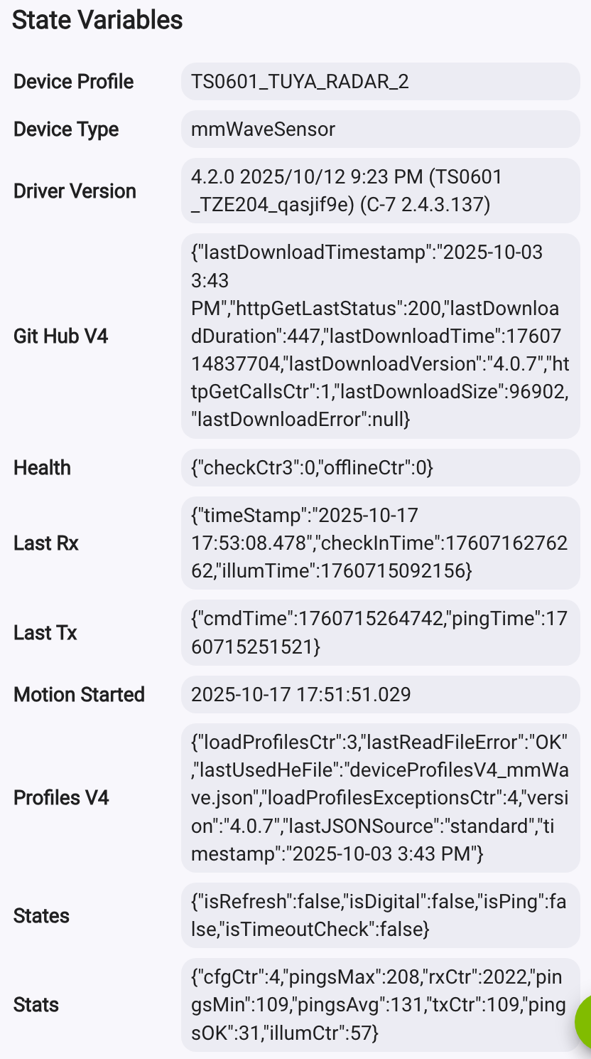

Can you download and try the Last ‘hardcoded’ mmWave driver version 3.5.2 from this Google Drive archive?
The name of the driver will contain 3.5.2. Change the ‘device type’ to the old driver and load the defaults. if your device works with the old driver version, then the problem is not in the HE platform.

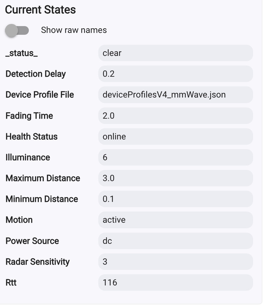

  • downgraded the platform, managed to get the sensor to respond
    BUT: motion value is INVERTED :smiley: ?!
  • platform upgrade: functioning but inverted motion remained
  • downgraded driver 3.5.2 reports motion properly
  • upgraded driver to latest : motion inversion returned
I have moved this device back to the TS0601_TUYA_RADAR profile, so the motion state being inverted problem should be fixed now.

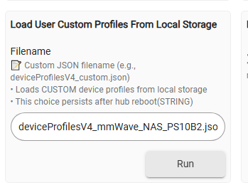

Then, copy the "deviceProfilesV4_mmWave_NAS_PS10B2.json" file to your HE hub File Manager.

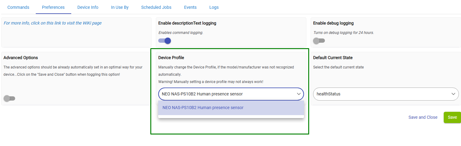

Enter the file name (including the .json extension) into the 'Load User Custom Profiles From Local Storage' parameter field and click on the Run button:

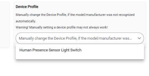

If the custom device profile JSON was parsed successfuly, you should see this :
Refresh the page and check whether the new device profile was selected automatically :

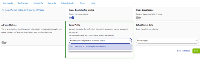

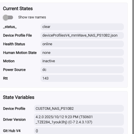

I can report that the 1st step went well...
But the driver was not automatically detected...
but it was selectable from 'preferences page'
and it now looks like...

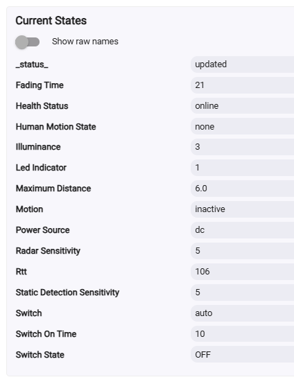

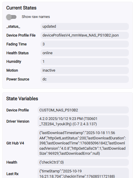

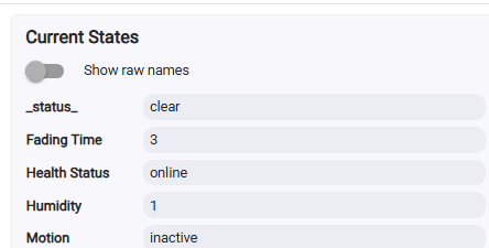

Sensor only detects motion (active) and goes to (inactive) after some period.
Current States shows :
Fading Time : (changeable via pref's)
Human Motion State (always as none)
Humidity (always as 1)
Power Source (always as DC) note: this is AC powered device

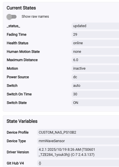

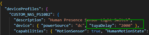

I have updated both the custom JSON (ver 1.0.2) and the driver code (ver 4.2.1).
There is a new 'tuyaDelay' settings in the device profile @andrea.veroni
@njanda send a 'LOAD ALL DEFAULTS' command from the Configure drop-down menu and then re-load the new custom JSON file. There should not be a humidity attribute for this device, most probably it is a leftover from other device profiles that you have tested.
If this setting only applies when the 'work mode' is set to automatic, it's better to remove the IlluminanceMeasurement capability for this device profile.
Unfortunately I don’t see a way this relay could be controlled from the hub, independently from what the current illumination measurement is. Seems it was designed for fully offline lights control, same operation as the dumb light sensor & switch control devices.
The json file has been updated and the driver cleaned out as below....

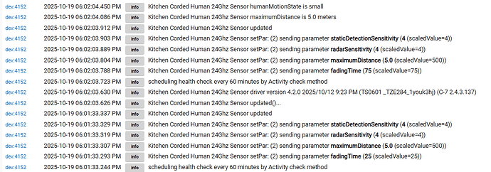

I was about to say that I tried setting the Fading Time and it appeared that it is not updating , as it shows "30" where as logs show that I updated it to 76..
BUT
Fading Time is updated if 'Advanced Options' is selected and saved. Maybe it should only be visible when 'Advanced Options' is enabled ?
Please update manually the driver code as well, should be 4.2.1.
This version supports configurable delay between the Zigbee commands - something that I suspect that may be a reason for some configuration commands to fail.
Thank you.
I have it loaded now....
Motion and Switch State change now, when motion is detected

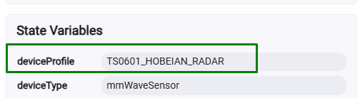

The inClusters list is matching the HOBEIAN radar model ZG-204ZV ...

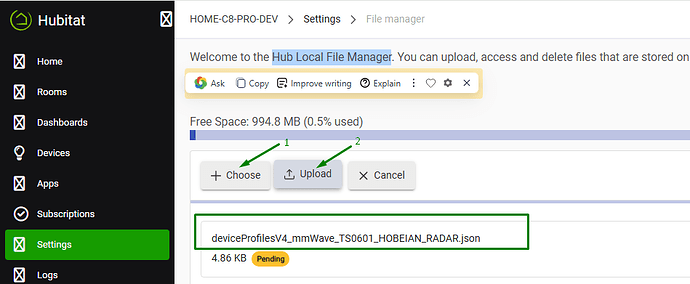

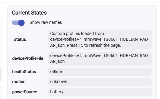

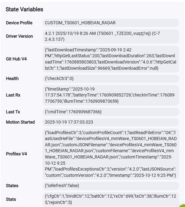

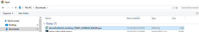

Download this custom JSON file :
https://raw.githubusercontent.com/kkossev/Hubitat/refs/heads/development/Drivers/Tuya%20Zigbee%20mmWave%20Sensor/customDeviceProfiles/deviceProfilesV4_mmWave_TS0601_HOBEIAN_RADAR.json

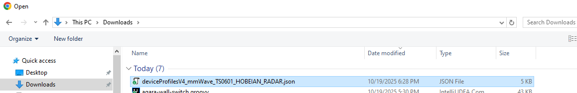

Store it on your PC as "deviceProfilesV4_mmWave_TS0601_HOBEIAN_RADAR.json".

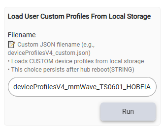

Then, transfer it to your Hub Local File Manager
Copy the "deviceProfilesV4_mmWave_TS0601_HOBEIAN_RADAR.json" filanameme and paste it into the "Load User Custom Profiles ..." input field, then click on the Run button :

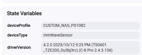

The 'Current States' status attribute should show a success message :

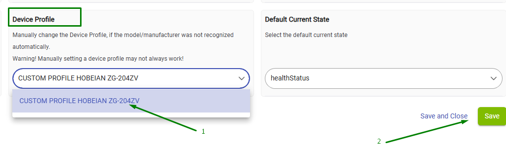

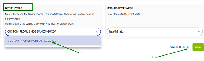

Refresh the HE device web page, then go to the Preferences tab. If the HOBEIAN custom profile is not selected automatically in the 'Device Profile' preference, select it manually :
Double-check that the TS0601_HOBEIAN_RADAR is shown in the State Variables section :

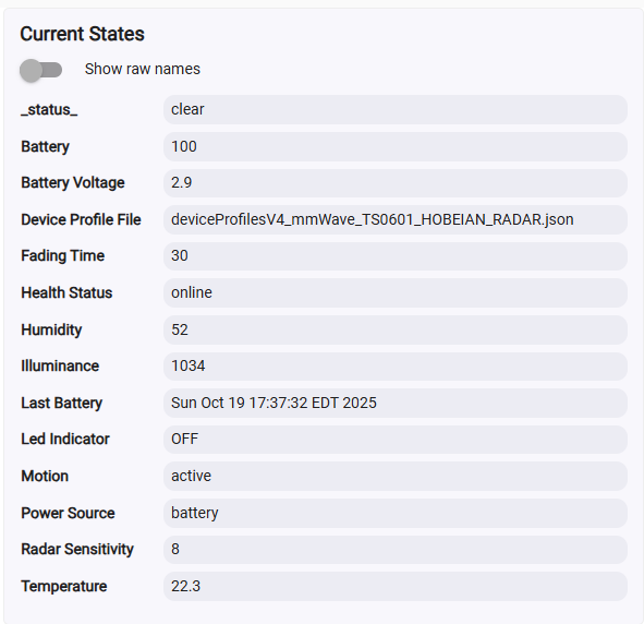

If you click on the 'Refresh' button, do you see the current device preferences/attributes populated in the 'Current States'? (Some Tuya devices will respond to this Refresh command, others will not...)
If Refresh is not working, power off the sensor for 15 seconds and then power it back on. Do you see a lot of Zigbee messages in the live log? The current states should be updated as well. Refresh the browser web page and make a screenshot of the Current States - this is needed to catch the factory default settings when a new device is paired to HE for the first time.
The latest driver version should also show the temperature and the humidity readings if reported by the device.
Thanks for you detailed message. It worked for the motion (partialy), iluminance and humidity (but it doesn't show as a humidity device for another app I'm trying to use with) and the power source (I'm using it connected to a USB C Cable but Current State says Battery). I can't control the detection distance neither even with the advanced options enabled. This is the log I get as soon as I disconnect and connect it again:
For the motion inactive I get this in the log but the driver it shows like active:
Human Presence Bathroom First Floor New motion is inactive (raw:0) (no change)

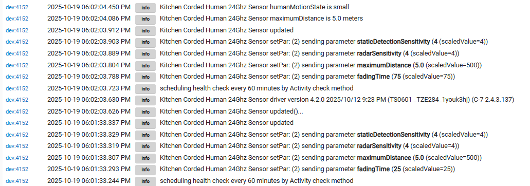

I thought to use the 'LED Indicator' parameter but despite what I do on the Preferences page, it always is showing in 'Current Status' as 1.
And overnight, or was it because I turned "Switch Work Mode' to Manual, illuminace value changed
But probably most weird is changing Fading Time (FT) does not appear to 'register' in 'Current Status' unless LED Indicator is toggled ON/OFF and saved. (the logs show it changed)
FT= 60. set FT as 38 & LED Off + Save then..refresh......FT still shows 60
FT= 60. set FT as 38 & LED ON + Save then..refresh......FT still shows 60
FT=60. set FT as 38 & LED ON + save = FT showing as 38
