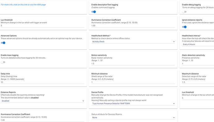

I noticed in the preferences,
Illuminance Correction Coefficient
Ignore distance reports
Is listed twice
This just a display error or do they do 2 different things?

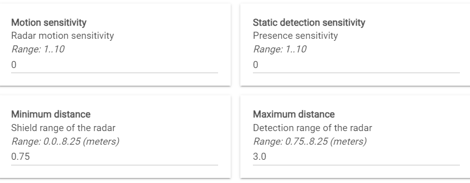

The missing 'large' motion in the 'humanMotionState' enum list is an easy fix; it will be in the next update. I will also fix the duplicated illuminance correction coefficient preference.
Much more difficult is to find out why some of the preferences for the _TZE204_7gclukjs device are not accepted...

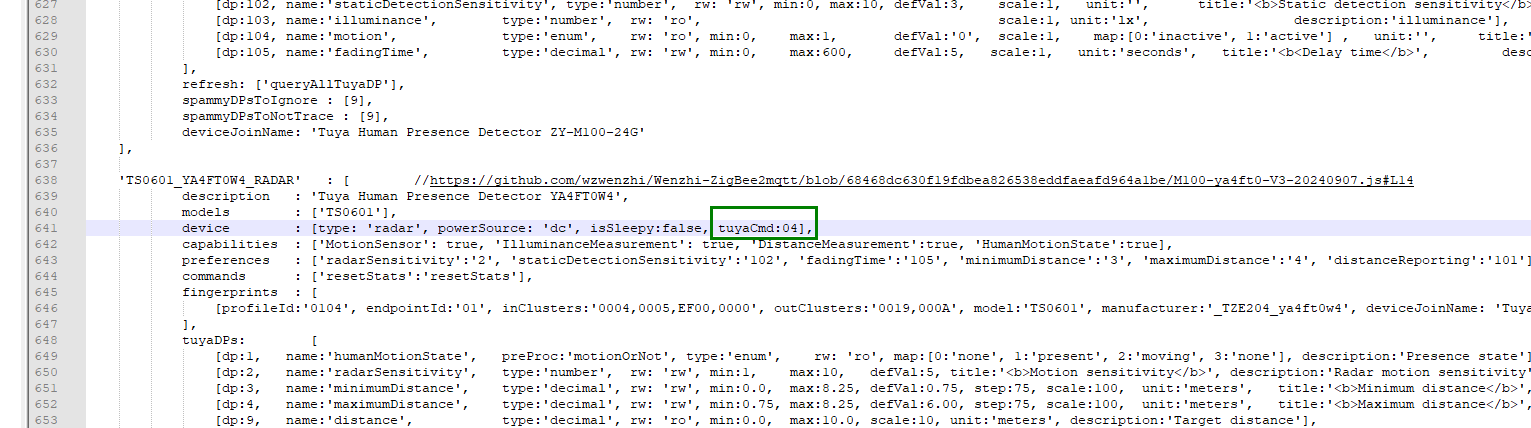

Can you try changing line 641 in the driver code and add , tuyaCmd:04
        device        : [type: 'radar', powerSource: 'dc', isSleepy:false, tuyaCmd:04],
then click on the Save button within the HE code editor.
The code should look like this :
Then try changing the parameters again and let me know whether there is any change - for better or for worse.

Done and Saved

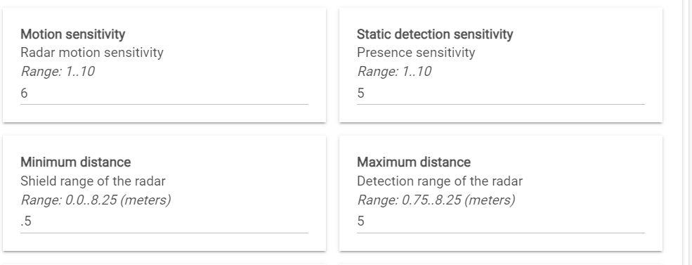

Before Changes
Changes
Save Preferences

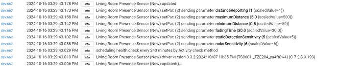

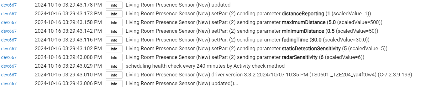

The related log

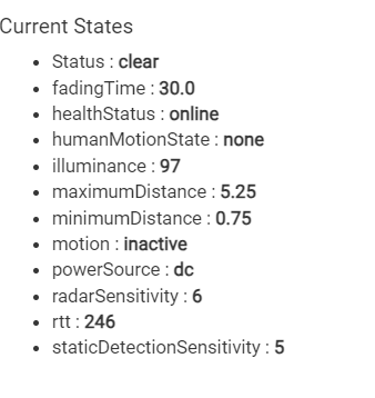

However, no change made to the Current States
Last time the Current States showed the change for a few minutes then reverted but this time no changes at all.
Here's the debug log after trying again
Debug Log
dev:6672024-10-16 03:35:07.886 PMdebugLiving Room Presence Sensor (New) Tuya check-in (AppVersion=38)
dev:6672024-10-16 03:35:07.882 PMdebugLiving Room Presence Sensor (New) parse: descMap = [raw:B8D2010000180100204AE2FF2038E4FF2000, dni:B8D2, endpoint:01, cluster:0000, size:18, attrId:0001, encoding:20, command:0A, value:4A, clusterInt:0, attrInt:1, additionalAttrs:[[value:38, encoding:20, attrId:FFE2, consumedBytes:4, attrInt:65506], [value:00, encoding:20, attrId:FFE4, consumedBytes:4, attrInt:65508]]] description=read attr - raw: B8D2010000180100204AE2FF2038E4FF2000, dni: B8D2, endpoint: 01, cluster: 0000, size: 18, attrId: 0001, encoding: 20, command: 0A, value: 4AE2FF2038E4FF2000

Thank you for the test and the logs. They show that this change was not successful... (in Tuya's world 'response: Success' without echoing back the changed parameter means actually 'command failed' :frowning:
You can revert to the old code.

I found I had to hit save multiple times for some parameters to save.
This was true for minimum distance and radar sensitivity
As for maximum distance I can get it to save after a few attempts, but I noticed this was the only parameter to revert to 2.25

@kkossev here's what happened: after inputting the values for motion sensitivity, static detection sensitivity, minimum distance, and maximum distance, I pressed 'Save Preferences' five times in a row between each refresh, then waited five minutes. The changes for motion and static detection sensitivities stuck, but minimum and maximum distances reverted. So, I updated the minimum and maximum distances again, repeated the 'Save Preferences' process five times in a row with each refresh, waited five minutes... but still, they didn’t stick.

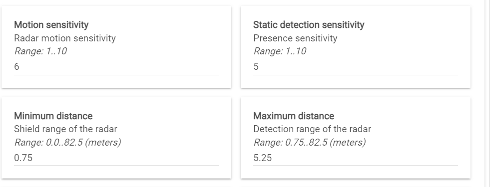

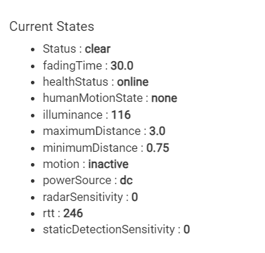

@DGBQ there is no solution yet for the _TZE204_ya4ft0w4 distance parameters changes not being retained by the device - same problem with Zigbee2MQTT.
Can you make another test (after updating the driver) - try changing the maximum distance parameter to a value multiplied by 10. I.e., if you want the maximum distance to be 5.25 meters - enter 52.5 in the preferences section and click on save. Refresh the device web page after a few seconds - will 52.5 setting be reverted to 5.25 ?
It seems that this device requires the distances to be a multiple of 75 centimeters. This means that the valid distance values (in meters) must be one of these :
0.0, 0.75, 1.5, 2.25, 3.0, 3.75, 4.5, 5.25, 6.0 ,6.75, 7.5
(for the test, use a 10 times bigger value!)

After updating both Motion sensitivity and Static detection sensitivity were defaulted to 0. These had to be updated in order to save preferences
I set Motion sensitivity to 5 and Minimum distance to 0 - Save preferences. Refresh webpage and device - both values seem to stay put.
I set Static detection sensitivity to 1 (i dont need static in this location really) and Maximum distance to 2.5 - Save preferences, current states dont update - refresh webpage and can see new current states - Refresh device and both Static detection sensitivity and Maximum distance revert back to 0 and 2.25 Respectively
Remembering your notes on multiples of .75 i change Maximum distance to 3 and keep setting Static detection sensitivity to 1 - Save device, again states dont change, refresh web page to see states updated. Refresh device and both revert back
Set both again and follow same procedure
Now Static detection sensitivity is the only parameter that keeps reverting from 1 to 0
It seems whatever i try, it does not stick!!
Hopefully this makes sense!!
appreciate all your work on this driver

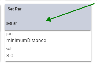

Adam, please try to change only one parameter at a time. It may be that when one parameter is sent with incorrect value (incorrect scaling), then the setting the others will also fail?
Can you do the above test?
Then, make a second test, changing only the minimum distance parameter :
  • set it to 0.3
  • set it to 30.0
    Will there be a change?
Please don't change more than one parameter at a time.

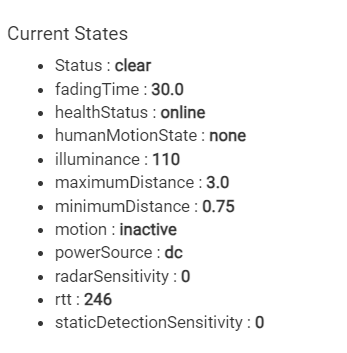

At the moment my Maximum distance of 3 has stuck and stayed put - This seems to work
Static detection sensitivity is the only parameter that doesnt stick!
I can try this now
Because Static detection sensitivity always reverts to 0, you need to change this parameter when saving other changes as you cant have it at 0. Must be minimum of 1
So in saying that set Static detection sensitivity to 1
Set minimum distance to 0.3
Save - referesh webbpage to see updated current states
Refresh device - minimum distance changed back to 0 ( which is what i want it on anyway) and Static detection sensitivity changes back to 0
So again, next time i need to change another parameter i also have to change Static detection sensitivity at the same time

Hold on, there is an easier way to change only one parameter - I will write the details now.
If you click on the 'Set Par' button without entering any parameters :
You will see in the live logs the accepted parameter names (they are different for each device)
infoRadar _TZE204_muvkrjr5 setPar: 'parameter' must be one of these : [radarSensitivity, staticDetectionSensitivity, fadingTime, minimumDistance, maximumDistance, distanceReporting]
Copy from the logs the name of the parameter that you want to change - for example minimumDistance . then paste it as a first parameter, and fill in the setting value - as example 3.0
Then click again on the button above
Observe the Curent States - will the parameter change?
@kkossev, based on your suggestions along with @bdydrp’s testing and findings, I was able to successfully retain the following values:
  • Motion sensitivity
  • Static detection sensitivity
  • Minimum distance
  • Maximum distance
The process is a bit convoluted, but here’s how I got it to work:
  1. Input all four values as desired.
  2. Ensure that minimumDistance is set according to the valid distance values provided below:
  1. Save Preferences
  2. StaticDetectionSensitivity may will revert to "0" at some point, but using the method of clicking the 'Set Par' button with both 'par' and 'val' completed makes it stick.
Hope this makes sense. Let me know if you need more information.
