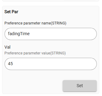

For troubleshooting a specific preference/parameter, you can use the setPar command.
Click on the Run button for a list of the settable parameters :
Then, try changing the preferences one by one, as example :
... I was testing this setPar() command with a Linptech/Moes radar and I see now a strange behaviour too... The device should report back the changed parameter, but it doesn't ... :thinking:
