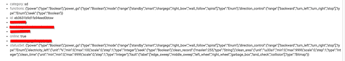

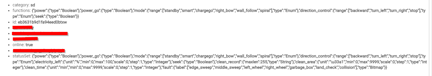

Just a question if anybody could help! I have a vacuum robot that is installed within smart life app. I can see it and control it from HE and webcore, but I cannot see any capability from webcore. Those capabilities are listed inside the device but dont know how to be able to use it. Here the list inside the HE device. Those are not in the webcore list of the device. Thanks!
