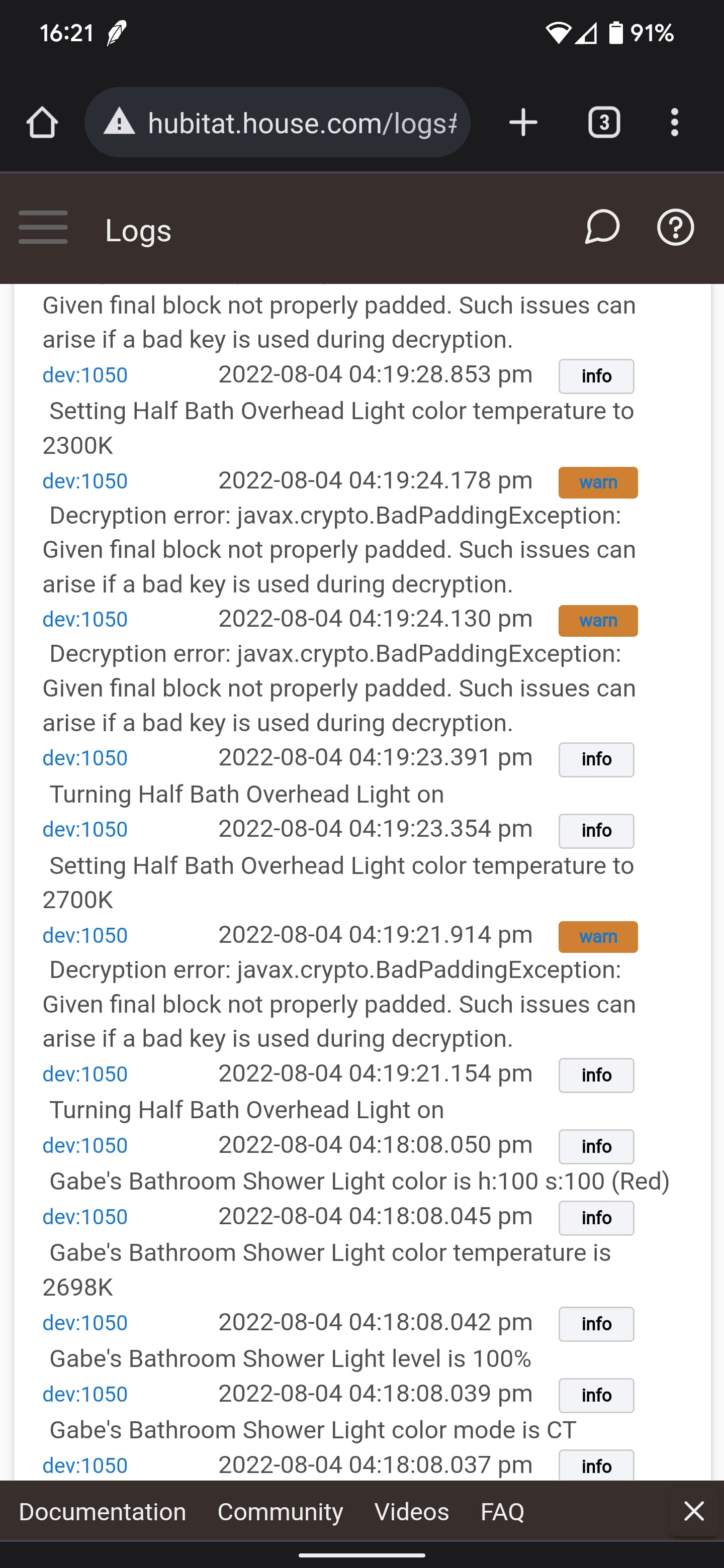

Ok, I think the issue is I was caching the cipher object and when the key changes the old cached cipher was still being used with an invalid key. I changed the code in the development branch to remove the cipher cache which should eliminate this.
Cool. I've flipped over to the DEV branch. I'll keep an eye on them for a few days and see what happens.

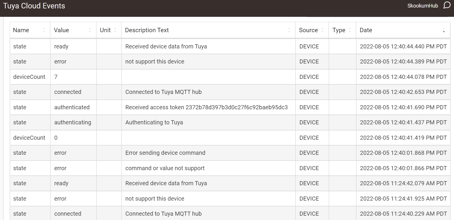

It looks like the device isn't supported in the Tuya cloud, but I can use it via Smartlife app no problem. I tried various commands (on/off/setspeed/cyclespeed etc) and only change in log I see is the error sending the device command that you see in the screenshot attached.

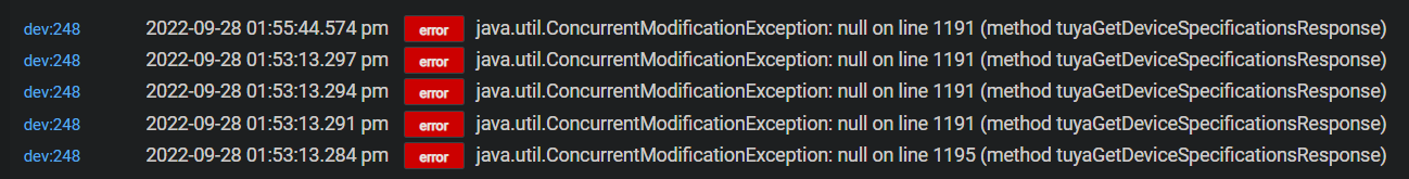

Did anyone else experience an issue with this driver this morning? After months of working without issue (thanks again @jonathanb) and no changes I was getting errors in the logs while gathering the device list. I can't check to see if it's cleared until later today. It was most likely a Tuya server issue (a permanent change or just a hiccup) but just wanted to see if anyone else experienced any issues before I dig in any deeper. Thanks
EDIT: It's back online now, there must've been an issue with Tuya's servers this morning.
Looks like that did the trick from some limited testing. I did see some errors in the logs while the devices were being added (this was a new setup on my dev hub).
