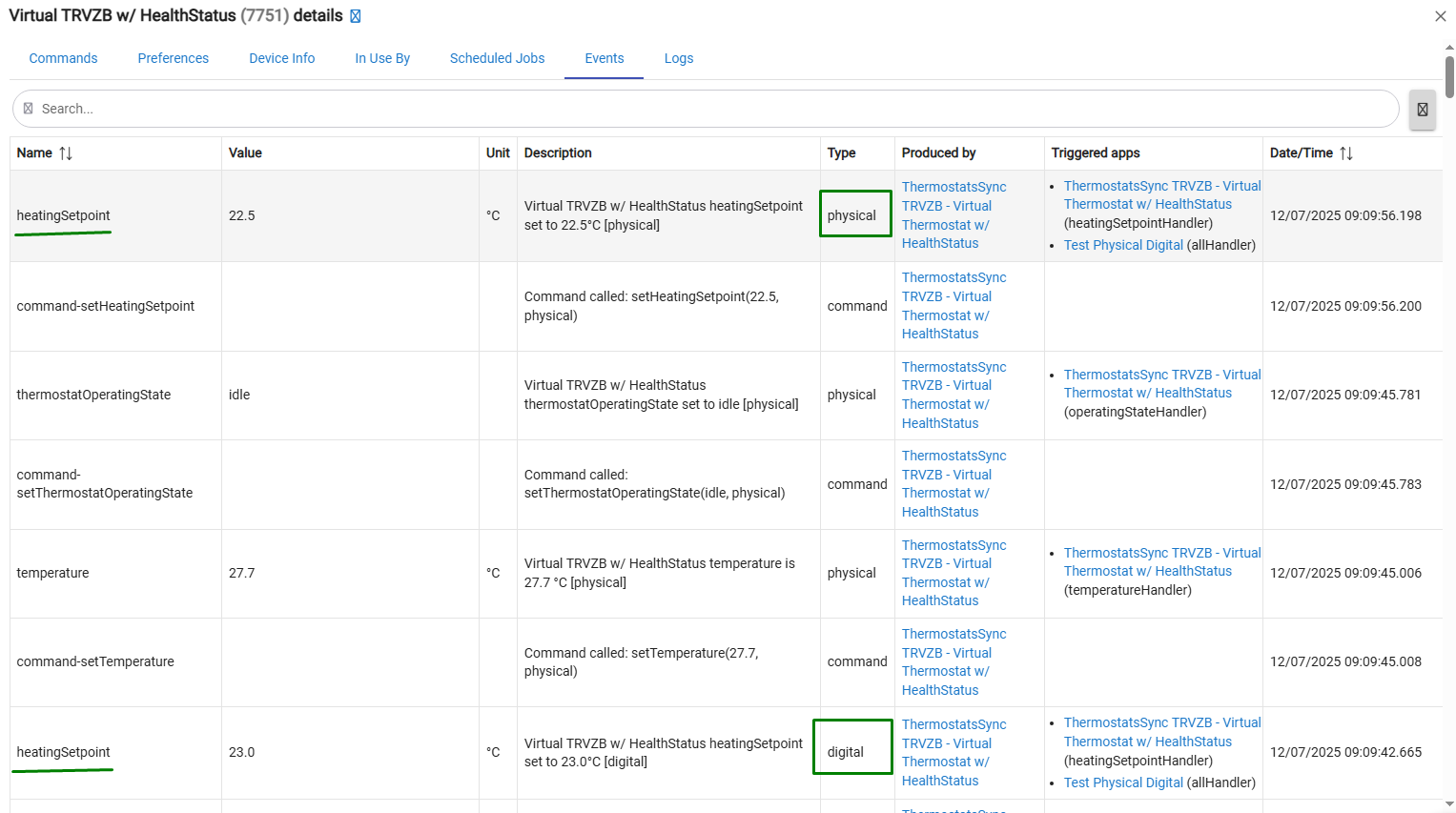

  • added syncEventType option to preserve physical/digital event designation when syncing attributes via command introspection

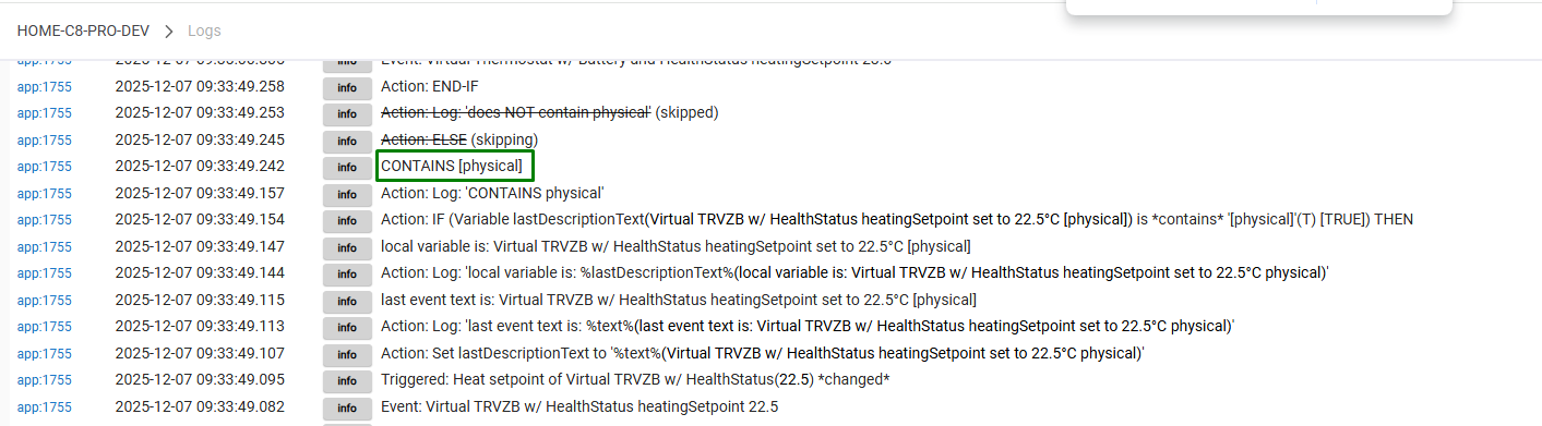

When using Virtual Thermostat w/ Battery and healthStatus driver, the real thermostat [digital] or [physical] event type is now synced to the virtual device :
This allows an RM5 rule to distinguish between digital events, such as changing the heating setpoint via the Thermostat Scheduler, and physical events, like a person manually adjusting the thermostat temperature with the device's knob.
This is the test RM5 rule :
Practical use : In the 'CONTAINS physical' branch of the RM5 rule, add commands to pause the Thermostat Scheduler for 5 hours, and then restore its automatic operation mode.
