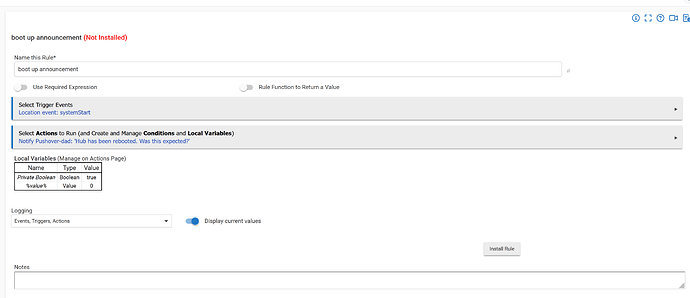

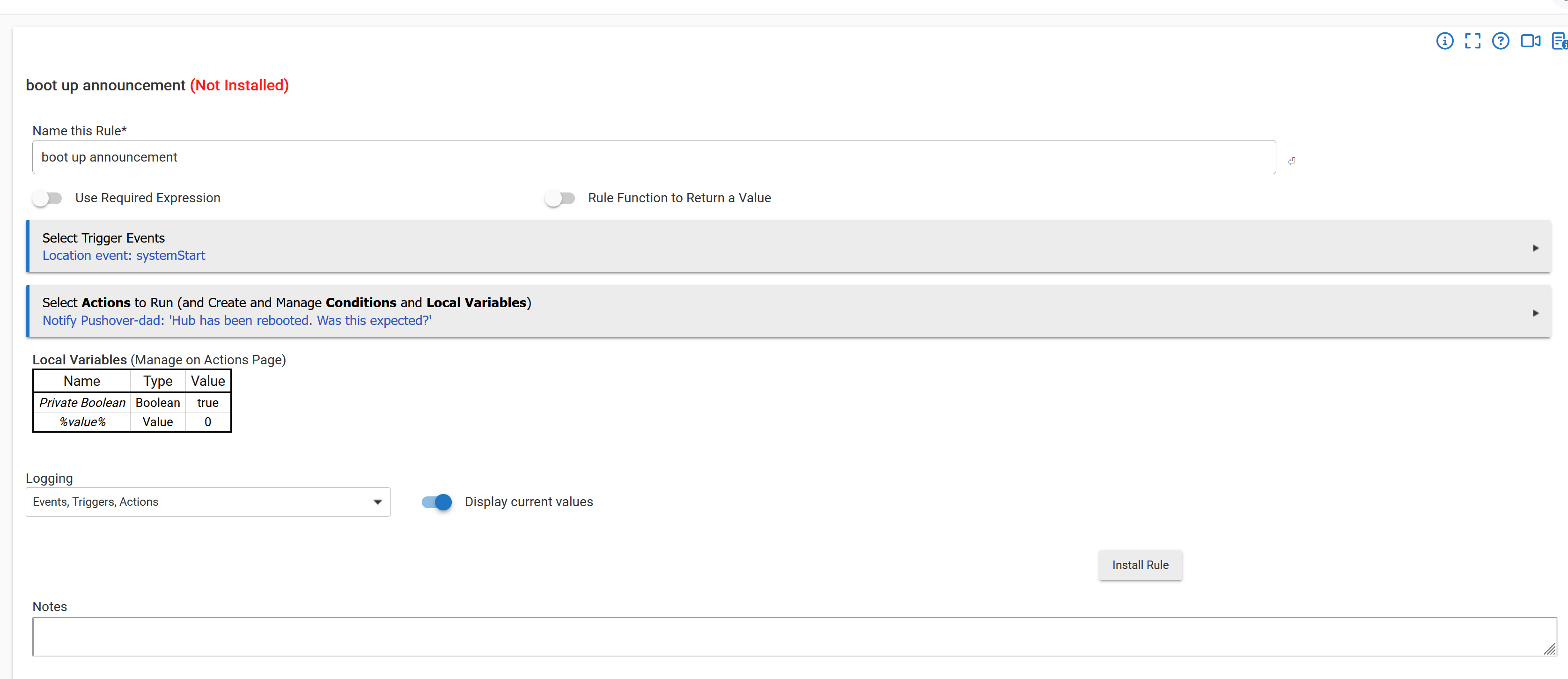

You can run a rule(s) at startup
Yeah, I know. Like I said, I already have that. But if the hub never powers down, it never restarts so the rule I currently have won't run.

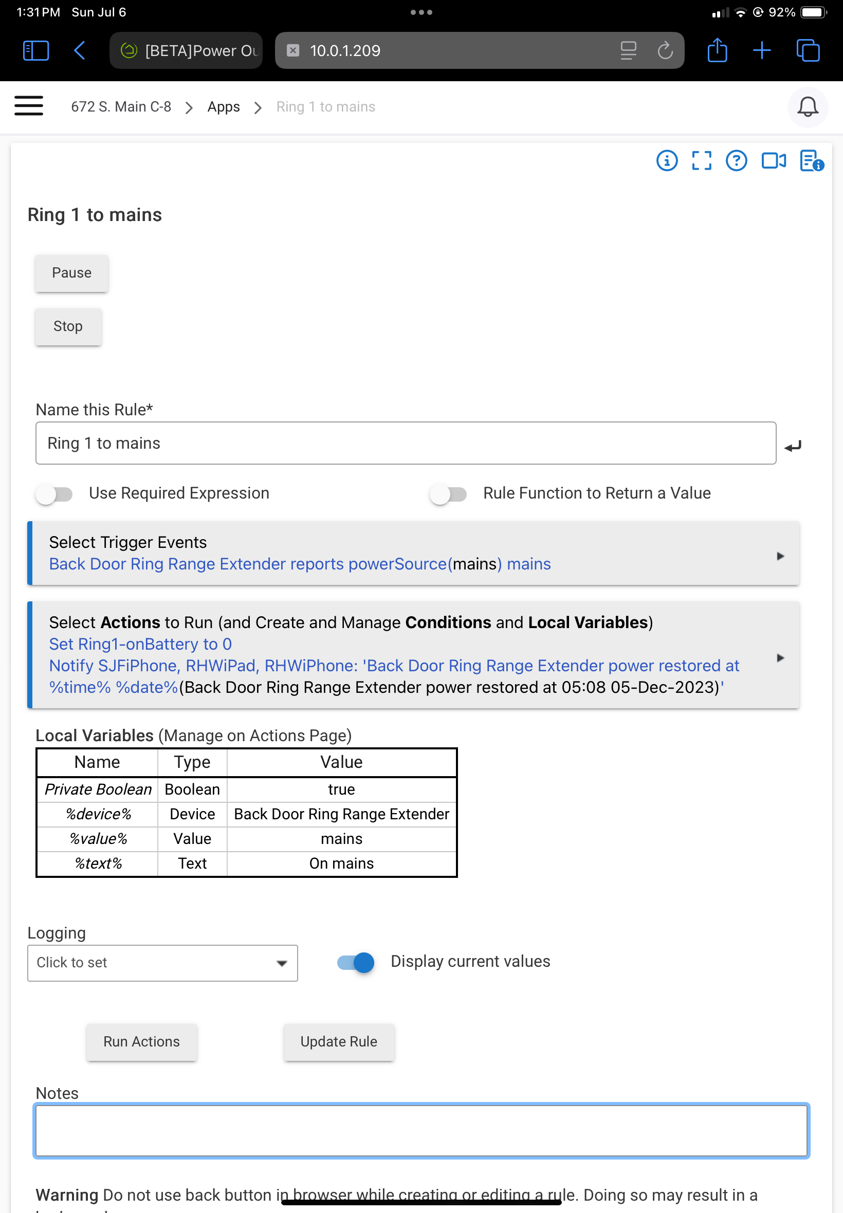

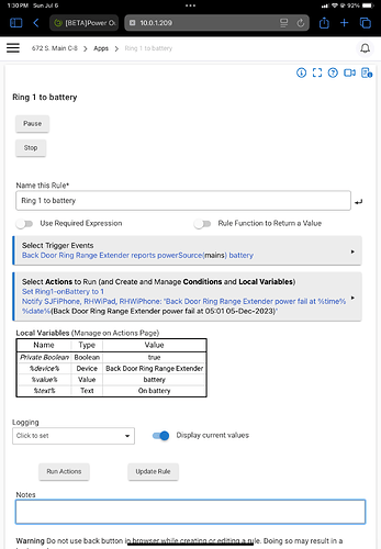

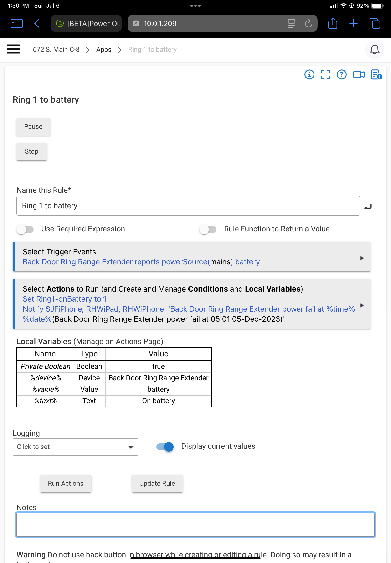

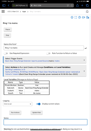

See the sample rules I posted above.
Thank you! I did have that working before I found the hub reboot/startup status (oddly hidden in "Location"??) but when I started adding additional sensors to prevent false positives I had too many complex rules. I found this app and I liked how it allowed me to do the detection, just need to be able to run various rules on restore. I may try the "and stays..." setting in the detection rule to make sure power is really off, but again this app already did that for me so I had a single point of source control.

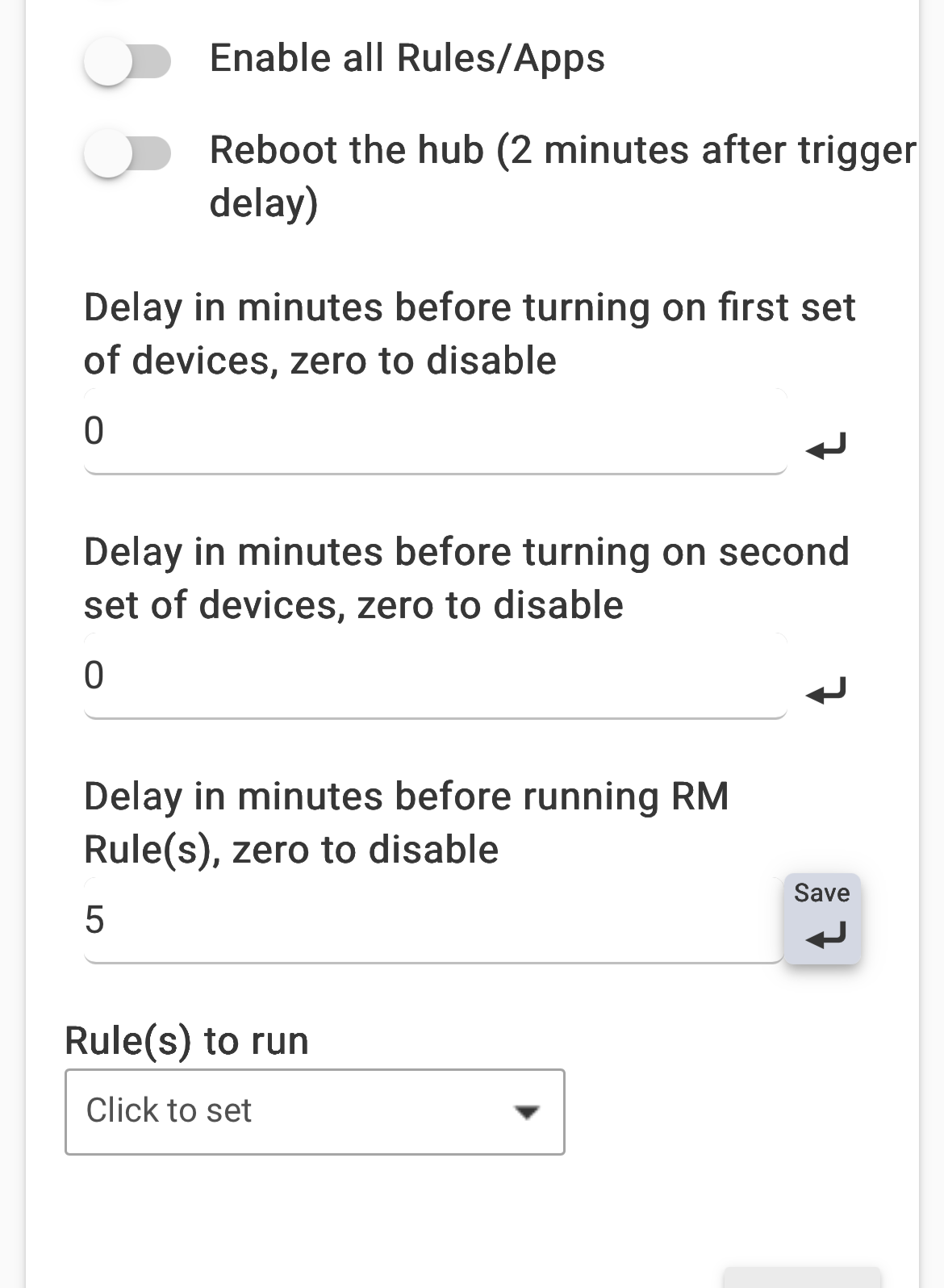

Under the Power Restore Actions if you set the delay to run rules to anything other than zero you well get the option to select what rules to run.
Had no clue, so sorry. Thank you so much!
LOL, no worries. Had quite a bit of input from the community on what they needed so I knew it was hidden in there - had to look at it myself though to make sure😎
